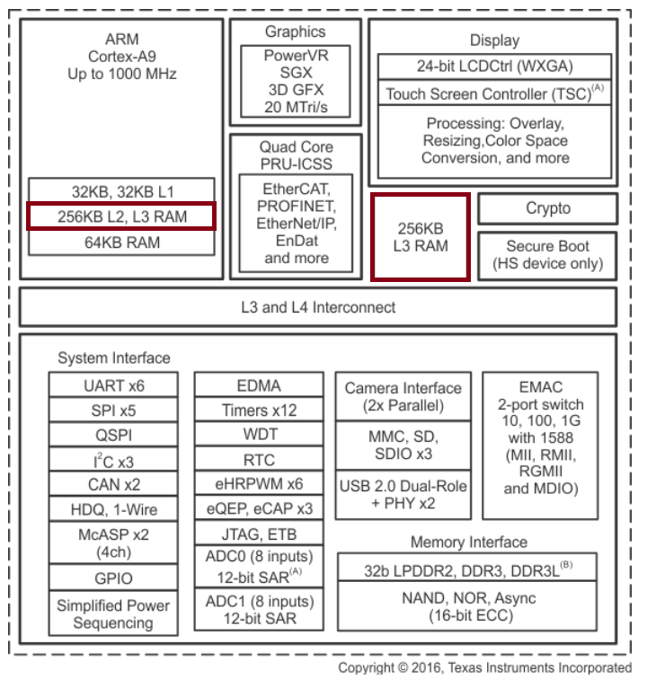

  • Hi Tim,  AM437x has 256K of L2 (or L3) RAM + 256 of L3 (OCMCRAM) as shown below:

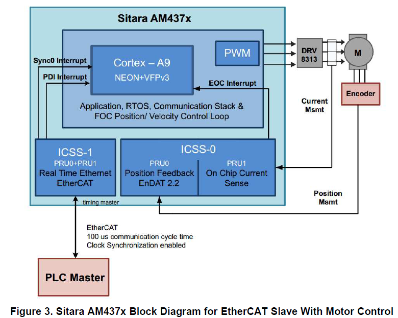

    About your PRU-ICSS question, unfortunately no, ICCS1 is used for EtherCAT and ICSS0 is used for motor control feedback

    >> AM437x ICSS0 and ICSS1 are not total symmetric (equals), so I believe EtheCAT slave cannot fit in ICSS0 (need to double check though)... Additionally, in AM437x devices there is up to two ports Ethernet switch. For 2 EtherCAT instances you will require 4. Please see AM4379 datasheet - PRU-ICSS section for details.
