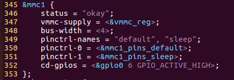

I have a problem relative to gpio registration.
I filled in cd-gpios field in mmc block of dts file. (the dts file is copy of am335x-evm.dts)
But, after entire booting, I could'nt see the gpio interrupt entry of mmc like shown.
My dts is like this.
Due to this problem, am3352 couldn't detect the mmc memory.

I'm working on custom board and SDK 2.0.2.11.
I am testing the mmc1 (=mmc0 in H/W) in order to use mmc3 (=mmc2 in H/W)
Somebody help me.
