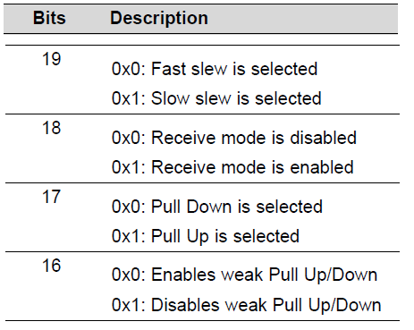

hi,I found that the register configuration that in the mux_dra7xx.h is  not compatible with the dra7x's datasheet,you can see the detail on the following:
\board-support\u-boot\arch\arm\include\asm\arch\mux_dra7xx.h
#define FSC        (1 << 19)
#define SSC        (0 << 19)
#define PEN       (1 << 16)
#define PDIS      (0 << 16)
  • Hi Samgyung,
    You are right, for bit 16 there is discrepancy. Bit 16 is not correct (description is reversed) in the code. Please follow the TRM description.
    I think the reason is that before, in OMAP5, setting to 1 enabled pullups.
    For bit 19 - the same story.
    Stan

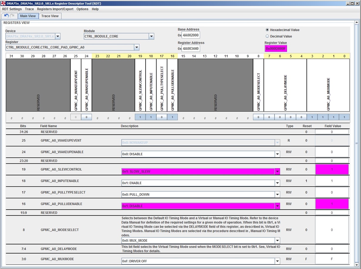

  • Samgyung,
    Stan is absolutely correct. In addition register settings are also pretty well visible in our Register Descriptor Tool (RDT) that we provide as complimentary to the TRM. Screenshot below:
    Alex

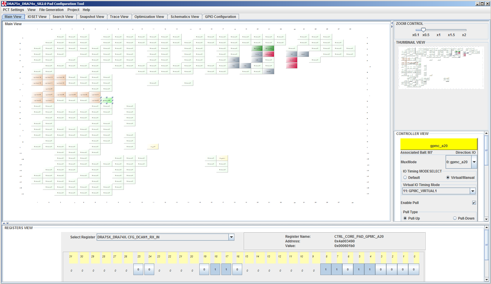

    • the Pad Configuration Tool (PCT) that is also available through your TI representative. This tool is an interactive software for visualization, modeling and configuration of the device pads. Basically CTRL module stuff that you can play with, generate file dumps and create your own software based on that configuration. Sample screenshot below:

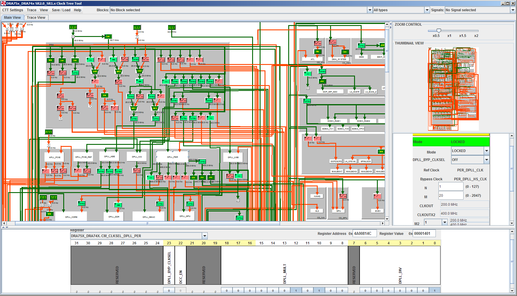

    • the Clock Tree Tool (CTT) that is available on  free of charge directly available to download! This Tool is an interactive software for visualization, modeling and configuration of the device clocks, DPLLs, switches, muxes, module states, and so on...basically PRCM stuff. Sample screenshot attached:
