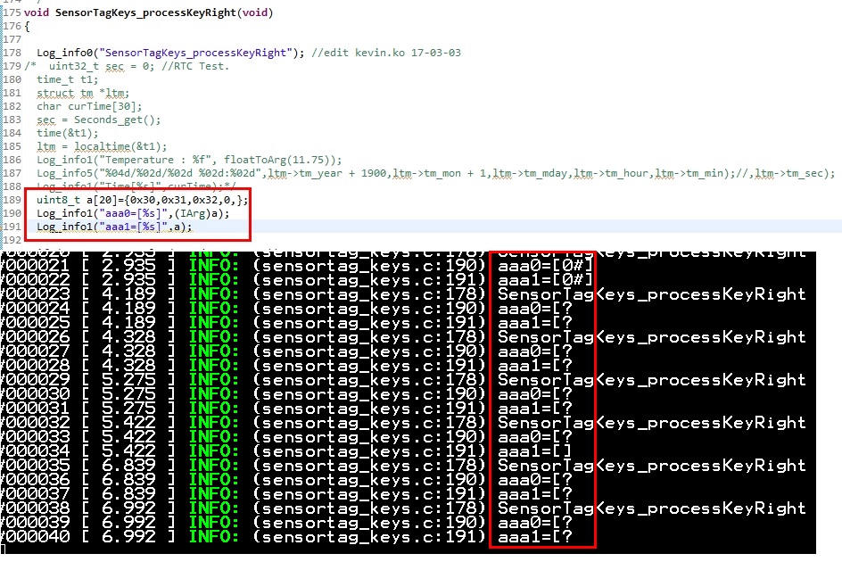

    How can i using 'Log_info1("aaa1=[%s]",a);' ?

  • Can you verify that the array 'a' in processKeyRight is not kept on stack? Use the debugger or just print the address. If it's not on stack, try printing the address just after the call to memcpy in uartLog_outputFxn. Use uartLog_evBuf[uartLog_head].arg[3] when printing the address. Finally, do the same just before line 80 in uartLog_doPrint, before you pass er->arg[3] to System_snprintf.
    All three should display the same address, and the address should not be somewhere on heap.
  • hello sasha
    address is all cheked but same problem.
    I spent a lot of time for Log_info %s %f
    I gave up using Log_info print %s and %f
    Thanks.
