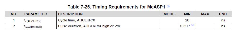

I need to use 98.304MHz on MCASP1 AHCLKR and ACLKR on TDA3.
According to the figure below, the maximum is 50MHZ.
According to the figure below, the maximum is 100MHZ.
What is the Max Clock of MCASP1 AHCLKR AHCLKR and ACLKR on TDA3 ?

    Furthermore, see Table 7-x. Timing Requirements for McASP1 in Data Manual to check the maximum frequency.

  • Hi, JP Park,
    The maximum allowed frequency for communication with companion device is presented in Timing Requirements and Switching Characteristics.
    In TDA3x case - Maximum allowed frequency for communication over McASP, between SoC and companion device, is 50MHz.
    Maximum Supported Frequency table lists the clock source options for each module on this device, along with the maximum frequency that module can accept. Those clocks are used from the module's integrated clock generators to adjust the required communication clocks.

  • JP Park,
    Please note that we have no AHCLKR pin in this device. 50-MHz restriction however applies also to the ACLKR pin and respective Transmitter pins.
    MCASP clock options are described in the TRM starting from Figure 24-114. McASP Module Block Diagram, and following 3 figures.
    You can see also that clocks can be derived from AUXCLK (up to 192 MHz).
    One way or the other, pins will limit MCASP to 50MHz.
