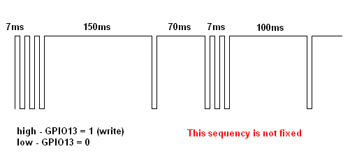

  • Hi Pratap,
    I am using the example CSL_MMCSD_SdCardFSExtExample (CSL 2.10) with some modifications to acquire and record audio signal from codec to SD card. Because audio signal has high sampling rate (for example 22050 Hz) will be necessary that the operation of write to SD is fast. I included GPIO functions as below to observe the time elapsed during an ATA_write operation.
    GPIO_write(hGpio, CSL_GPIO_PIN13, 1); // put pin to high
    ata_error = ATA_write(pAtaFile, gMmcWriteBuf, CSL_MMCSD_ATA_BUF_SIZE);
    GPIO_write(hGpio, CSL_GPIO_PIN13, 0); // put pin to low
    I observed the GPIO13 with a digital oscilloscope and the times varies according the figure above. This variability (150ms) impedes my sound acquisition and the recorded file becomes useless. Other interesting observation was when I changed the CSL_SD_CLOCK_MAX_KHZ to 50MHz and the times still the same.
    I debug the ATA_write function using Step Into and Step Over and I do not come to a conclusion.
    Please, I imagine that you are very busy but could you help me understand what is happing? Will be possible fix it?
    Thank you very much.
    Andrea
  • Hi Andrea,
    At what CPU clock frequency you are running the SD card example?. What is the SD card you are using?.
    ATA_write() should not take 150ms. Also it should not be so much varying. You should be able to write the data to SD card recorded at 22050 using ATA_write. Try disabling the MMC/SD data caching by commenting 'ENABLE_CACHE' macro in csl_mmcsd_ataIf.c file. In the absence of caching, in ideal case you should see the consistent write timing.
    Pratap.
  • Dear Pratap, thank you so much for attention. I did what you recommended but the variability still.
    I would like to give you more information about my tests:
    1.   sysClock = 100MHz;
    2.   CSL_MMCSD_ATA_BUF_SIZE  =  256u;
    3.   CSL_SD_CLOCK_MAX_KHZ  =  20000u. I changed to 50000u but still the same times (why?);
    4.   I commented out the POLL MODE part and I am using only the DMA MODE (because the performance is better);
    5.   I included the switches functionality to stop the program;
    6.   Before ATA_write I use a while () to keep write;
    7.   After ATA_write I use the ATA_seek_relative to appended new data to the file on SD;
    8.  My carde is 4GB SDHC Kingston;
    9.   After the message “ File Creation/Open on SD card is Successful” of mmcConfigFs() function I put Run = TRUE and the code below:
    while(Run)
    key = Get_Sar_Key(); // Verify SW
    ATA_seek_relative(pAtaFile, 0);
    if(key == SW2) // If SW2 pressed
          Run = FALSE;
    ata_error = ATA_close(pAtaFile);
    The file is saved on SD but the time variability is present. Please, could you give me more hints about this time variability?
    Thank you very much!!!
    Andrea
