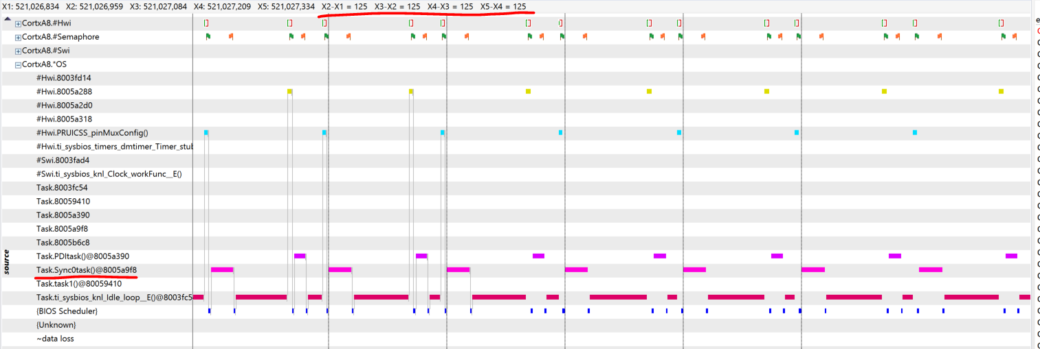

  • Hi Laurence,
    actually in AM335x INTC '0' is highest IRQ priority. However it also requires special setup for nested IRQs. I am not sure if that is enabled in your system. In the view you provide there are no issues with HWI as they seem to be pretty short.
    What seems to take really long is your Sync0Task(). This seems to take a lot of  CPU time until pre-empted. Maybe this has a while() and no task_yield() or task_sleep()?
    I also don't understand your measurements here. You should set the xN markers to begin and end of a task. Here it looks like you are measuring a cycle.
    For sure UIA is not the issue here as it is quite efficient and just takes short time stamps on begin and end of tasks or HIWs. The calculations are done later on the debug PC. Otherwise all your tasks would look like they take a long time. Of course there is a little bit of influence due to debug but that can't be avoided. You may later remove all debug and UIA code and then measure with HW signals only for final verification of timing.
    But first you should fix the issue with Sync0Task(). Either it needs too much computation power (increase the CPU clock...) or it just loops without releasing the CPU. That may be ok as long as it really is the lowest prio task here.

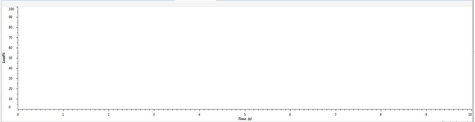

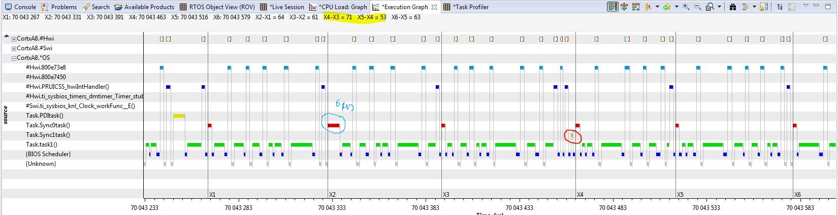

  • Hello Frank,
    First of all I would like to thank you for your help.
    I have worked a little with UIA and I have some results:
    1. In the timingsimple.jpg file, I have put a graph made with a simple program where no function for calculation is called in the Sync0_Isr().
    On this graph, we can see that the sync0 task is quite little (from 2 to 6 us): there is plenty of time left to do other things.
    We also see that, as I asked in my ethercat configuration, my sync0 has a cycle time close to 62us (62,5us), my sync1 500us and my PDI 500us. But we can also see a big jitter on sync0 when sync1 is called: 71us before and 53us after !
    Can you explain me why this jitter occurs ?
    2. In the timingcomplet.jpg file, I have put a graph made with a complex program where my real function for control motor is called in the Sync0_Isr().
    On this graph, we can see that the sync0 task is very big (from 35 to 42 us): there is a big problem of time remaining....
    I find the same results when I use an oscillloscope and TestPoints to visualize timing.
    Of course, I have made these graph in a debug mode. In a release mode my sync0 task is smaller: 16us max. But it is still an annoying subject for us.
    I would like to visualize CPU load to confirm this point of view but I have a problem: there is no graph drawn when I use it (cpuLoad.jpg file)
    Can you tell me How to use CPU Load ?
  • Hi Laurence,
    yes, I am trying to help but we are reaching an area where I can't help a lot anymore. This is a typical system optimization scenario. This requires full access to the system and giving good advice on the basis of a few screenshots is nearly impossible. Also it is outside of our support scope I believe.
    It seems you are at the edge of what the processor is able to perform (at least with current clocks and in debug mode). As such you may exhibit the normal SW jitter in a non-deterministic processing core. Here you will have dynamics like cache and so on.
    Usually motor control algorithms are computing intense but I guess if you compile that part with full optimization your system timing will improve. At some point of release configuration you may lose the UIA debug capability but that is to be assumed.
    Concerning the UIA load function I assume this is documented otherwise you will need to ask in the CCS forum. I haven't used this a lot.

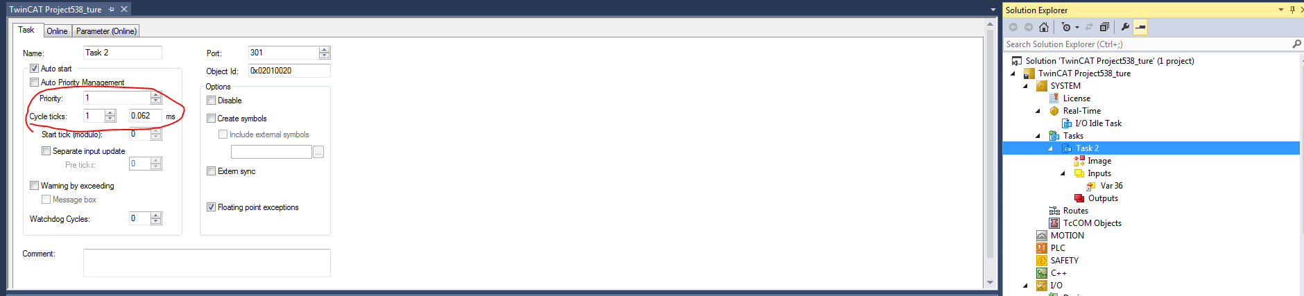

        I met a question on my UIA when test time. But the time is wrong. I set the cycle time 62us in the twincat. It should be 62us for sys0task cycle time but in my UIA, it show me 125us in below pic. it look like double. Because when I set 50us in the twincat, the UIA show 100us (x1-x2) .  Do you have any idea?
    Thank you for your help
