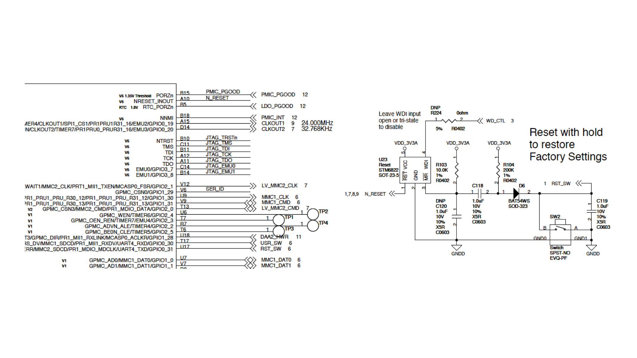

We have a custom board based on the AM3358 and is very similar to the Beaglebone Black. I have attached the relevant schematic for the reset circuit.
We would like to implement a scheme where a long press of the switch SW2 is detected and we can implement a "Factory Reset".
The state of the reset signal can be read through GPIO0_31. However the issue is that as soon as the switch SW2 is activated than we reset the system.
Is there any scheme that you can suggest to help implement this? Any examples that we could look to?
