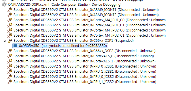

mcasp_Audio_evmAm572x_c66Example is working  after stop in step  linux boot.
but not working after completed to linux kernel booting  completed.
step
1. linux kernel booting  completed.
2. connected dsp1 in device of CCS
 3. out file (MCASP_Audio_evmAM572x_c66ExampleProject.out) to run in menu of ccs.
 4. happened error in
Void Audio_echo_Task()
volatile int32_t i32Count, status = 0;
hMcaspDev2 = NULL;
/* 1. EDMA Initializations */
EDMA3_DRV_Result edmaResult = 0;
/* Enable all McASP events */
sampleEdma3GblCfgParams[0].dmaChannelHwEvtMap[0] |= 0xFFFFu;
hEdma_0 = edma3init(0, &edmaResult);  <----- here error
