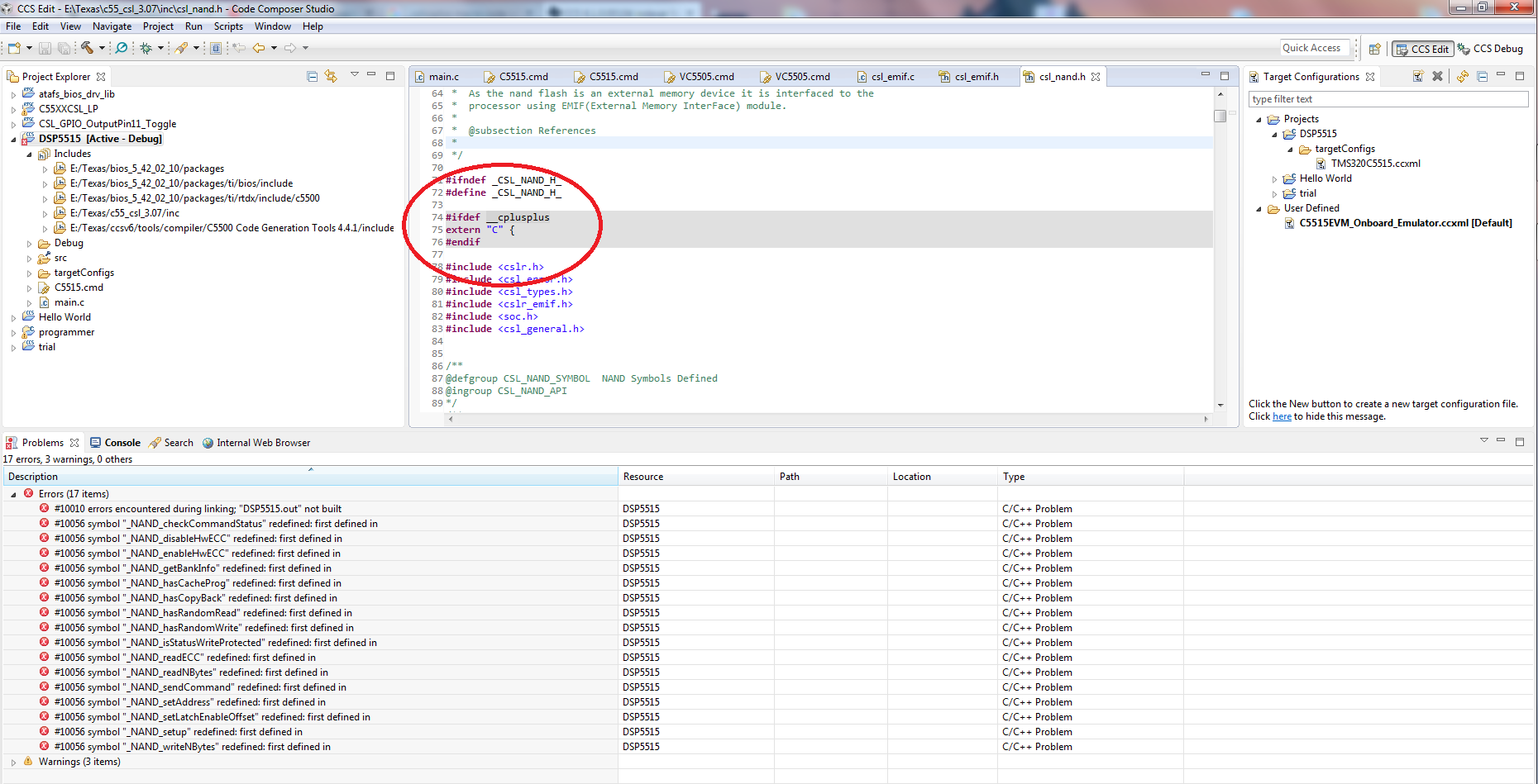

I am trying to install CSL3.07 on CCSv6.1 I have never done it before and I am having a hard time. I posted to the CCS forum was told to ask my ask questions here. My previous posts that show the steps I took are here: https://e2e.ti.com/support/development_tools/code_composer_studio/f/81/p/583301/2144003.

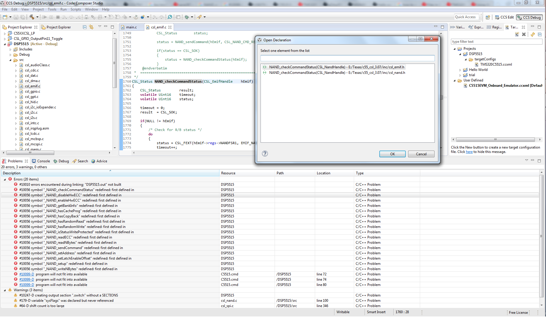

I am still having some problems. Please have a look at the pic below. I believe all "nand" related errors are because, the functions shown in the error tab are defined both in csl_nand.c and csl_emif.c and declared both in csl_nand.h and csl_emif.h (names of the functions are same, only the arguments are of different type). When I tried go to one of the function's declaration I am given 2 options, as seen in the pic, to go to as CCS finds 2 declarations (and also 2 definitions). If I remove lets say csl_emif.c the errors disappear. I won't be using either emif or nand. If you say it will be a viable solution, I can get rid of them but still want to know why the files were created this way and correct way to use them.
Another problem is the linker file. I found a suitable linker file on the forum that enables the use of printf and I am using that one ( given in: https://e2e.ti.com/support/development_tools/code_composer_studio/f/81/p/215845/761954 ). It seems that I need to customize the linker to my needs. I have started reading 9.6.4 in www.ti.com/.../spru280i.pdf  as suggested in one of the post. If have suggested solutions I would like to hear them (especially if you think this is not a part of the installation process). My log console is given below the pic.
For both of my problems what I want to know is, did you have similar problems too while installing CSL or it is just me doing some fundamental mistake. It is the first time I am installing CSL.

**** Build of configuration Debug for project DSP5515 ****
"E:\\Texas\\ccsv6\\utils\\bin\\gmake" -k all
'Building file: ../src/csl_emif.c'
'Invoking: C5500 Compiler'
"E:/Texas/ccsv6/tools/compiler/C5500 Code Generation Tools 4.4.1/bin/cl55" -v5515 --memory_model=large -g --include_path="E:/Texas/bios_5_42_02_10/packages/ti/bios/include" --include_path="E:/Texas/c55_csl_3.07/inc" --include_path="E:/Texas/bios_5_42_02_10/packages/ti/rtdx/include/c5500" --include_path="E:/Texas/ccsv6/tools/compiler/C5500 Code Generation Tools 4.4.1/include" --include_path="E:/Texas/bios_5_42_02_10/packages" --define=c5515 --display_error_number --diag_warning=225 --ptrdiff_size=16 --algebraic --asm_source=algebraic --preproc_with_compile --preproc_dependency="src/csl_emif.pp" --obj_directory="src" "../src/csl_emif.c"
'Finished building: ../src/csl_emif.c'
'Building target: DSP5515.out'
'Invoking: C5500 Linker'
"E:/Texas/ccsv6/tools/compiler/C5500 Code Generation Tools 4.4.1/bin/cl55" -v5515 --memory_model=large -g --define=c5515 --display_error_number --diag_warning=225 --ptrdiff_size=16 --algebraic --asm_source=algebraic -z -m"DSP5515.map" --stack_size=0x200 --heap_size=0x400 -i"E:/Texas/ccsv6/tools/compiler/C5500 Code Generation Tools 4.4.1/lib" -i"E:/Texas/ccsv6/tools/compiler/C5500 Code Generation Tools 4.4.1/include" --reread_libs --display_error_number --warn_sections --xml_link_info="DSP5515_linkInfo.xml" --rom_model --sys_stacksize=0x200 -o "DSP5515.out" "./main.obj" "./src/csl_audioClass.obj" "./src/csl_cdc.obj" "./src/csl_dat.obj" "./src/csl_dma.obj" "./src/csl_emif.obj" "./src/csl_gpio.obj" "./src/csl_gpt.obj" "./src/csl_hid.obj" "./src/csl_i2c.obj" "./src/csl_i2c_ioExpander.obj" "./src/csl_i2s.obj" "./src/csl_intc.obj" "./src/csl_irqplug.obj" "./src/csl_lcdc.obj" "./src/csl_mcbsp.obj" "./src/csl_mcspi.obj" "./src/csl_mem.obj" "./src/csl_mmcsd.obj" "./src/csl_mmcsd_ataIf.obj" "./src/csl_msc.obj" "./src/csl_nand.obj" "./src/csl_pll.obj" "./src/csl_rtc.obj" "./src/csl_sar.obj" "./src/csl_sdio.obj" "./src/csl_spi.obj" "./src/csl_sysctrl.obj" "./src/csl_uart.obj" "./src/csl_uhpi.obj" "./src/csl_usb.obj" "./src/csl_wdt.obj" "./src/evm5515.obj" "./src/evm5515_gpio.obj" "./src/evm5515_i2c.obj" "./src/vectors.obj" "../C5515.cmd" -l"libc.a"
<Linking>
error #10056: symbol "_NAND_enableHwECC" redefined: first defined in
"./src/csl_emif.obj"; redefined in "./src/csl_nand.obj"
error #10056: symbol "_NAND_setup" redefined: first defined in
>> Compilation failure
error #10056: symbol "_NAND_readNBytes" redefined: first defined in
error #10056: symbol "_NAND_hasCacheProg" redefined: first defined in
error #10056: symbol "_NAND_hasCopyBack" redefined: first defined in
error #10056: symbol "_NAND_hasRandomWrite" redefined: first defined in
error #10056: symbol "_NAND_setAddress" redefined: first defined in
error #10056: symbol "_NAND_setLatchEnableOffset" redefined: first defined in
error #10056: symbol "_NAND_sendCommand" redefined: first defined in
error #10056: symbol "_NAND_isStatusWriteProtected" redefined: first defined in
error #10056: symbol "_NAND_readECC" redefined: first defined in
error #10056: symbol "_NAND_writeNBytes" redefined: first defined in
error #10056: symbol "_NAND_getBankInfo" redefined: first defined in
error #10056: symbol "_NAND_disableHwECC" redefined: first defined in
error #10056: symbol "_NAND_hasRandomRead" redefined: first defined in
error #10056: symbol "_NAND_checkCommandStatus" redefined: first defined in
warning #10247-D: creating output section ".switch" without a SECTIONS
specification
"../C5515.cmd", line 74: error #10099-D: program will not fit into available
memory. placement with alignment/blocking fails for section ".text" size
0x20835 page 0. Available memory ranges:
DARAM1 size: 0x2000 unused: 0x2000 max hole: 0x2000
"../C5515.cmd", line 80: error #10099-D: program will not fit into available
memory. run placement with alignment/blocking fails for section ".bss" size
0x29ec page 0. Available memory ranges:
DARAM5 size: 0x2000 unused: 0x2000 max hole: 0x2000
"../C5515.cmd", line 72: error #10099-D: program will not fit into available
memory. placement with alignment/blocking fails for section "vectors" size
0x200 page 0. Available memory ranges:
VECS size: 0x100 unused: 0x100 max hole: 0x100
error #10010: errors encountered during linking; "DSP5515.out" not built
gmake: *** [DSP5515.out] Error 1
gmake: Target `all' not remade because of errors.
**** Build Finished ****

    Regarding the multiple function definition/declaration problem. It is because of the function overloading. The functions with the same name (and with different arguments) have to be defined in the ‘ extern “C” {} ‘ block. However for this, __cplusplus has to be defined. In my case it is not and condition is grayed out. Please have a look at the pic. Obviously I have some mis-settings or something. I am now working on this. I will be glad if you can please suggest me some solutions.

    I was able to successfully build the project after some changes. Please find the working project attached. Here is what my CCS workspace looks like below with the .out in the Debug folder. Please ignore the blurred out areas as they aren't relevant to your project. I removed the src folder from your project as it was causing the redefinition error you were seeing. Its best to pick up those definitions from the C55XXCSL_LP.lib instead which is can be imported into your workspace from C:\ti\c55_lp\c55_csl_3.07\ccs_v6.x_examples\C55XXCSL_LP. You will also need atafs_bios_drv_lib as well to build. Take a look at how I added the .lib in the linker section of your project properties.
    Your csl_general.h looks good.
    The default linker command (.cmd) files in CCS have problems are we are in the process of fixing these in a future CCS release. Apologies for that.
