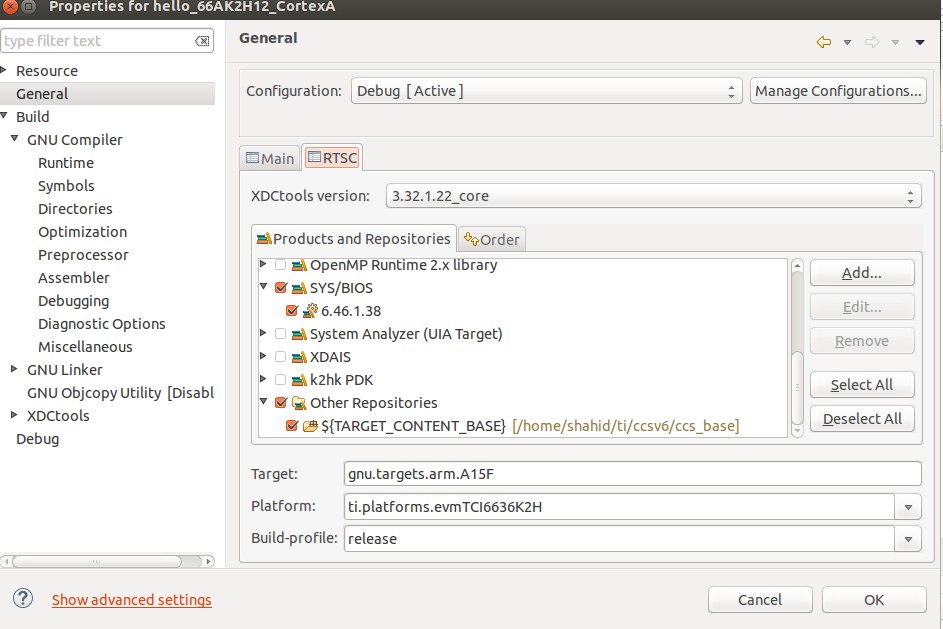

I have recently bought EVMK2H board and i have tried bare metal examples on ARM using GNU v4.9.3 compiler as well as DSP using TI compiler.
Now i am trying to build the SYS/BIOS Hello world project to get started with the EVMK2H board. Below is the link i followed to build the SYS/BIOS hello world project:
processors.wiki.ti.com/.../Processor_SDK_RTOS_Examples
3) RTSC settings
4) I have also added the xtcievmk2x.gel files
Q) But when i try to build the SYS/BIOS Hello world project it gives me Virtual Floating point register(VFP) errors. I believe the compiler is configured to hard-float-abi, the error message indicates that at least part of the system is using soft-float abi. Do i need to replace this in GNU compiler flag set. I AM NOT SO SURE. Can anyone help me solve this issue ? The build logs are shown below
