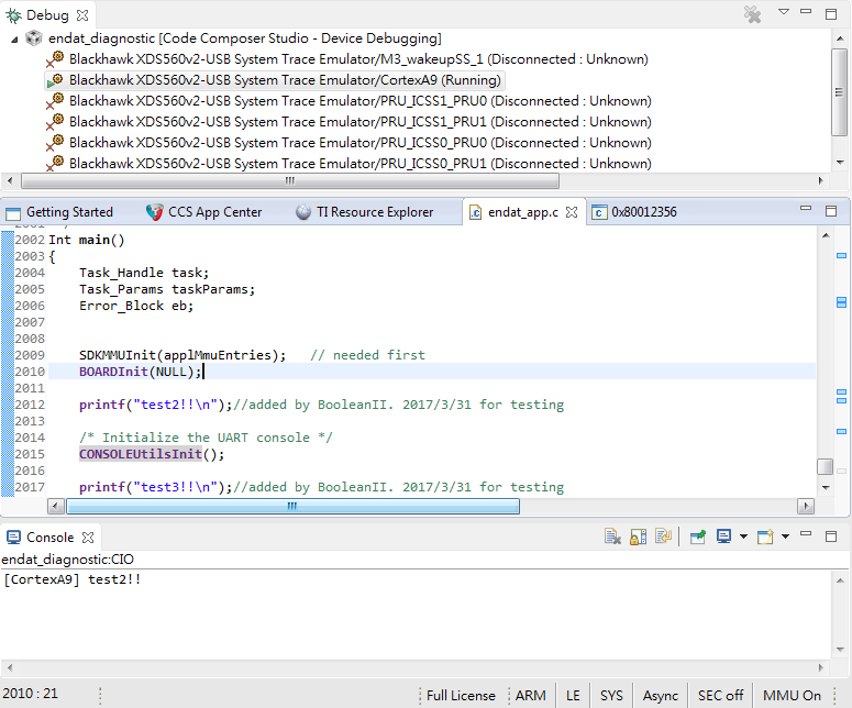

When I run the endat diagnostic example code, it will get stuck in CONSOLEUtilsInit() function and never comes out
I use "run-> Step Into" to trace where the code is running, but it is seems not working
CCS won't show where the code is running
How can I trace the code in better way?
Is there any suggestion to solve this problem?

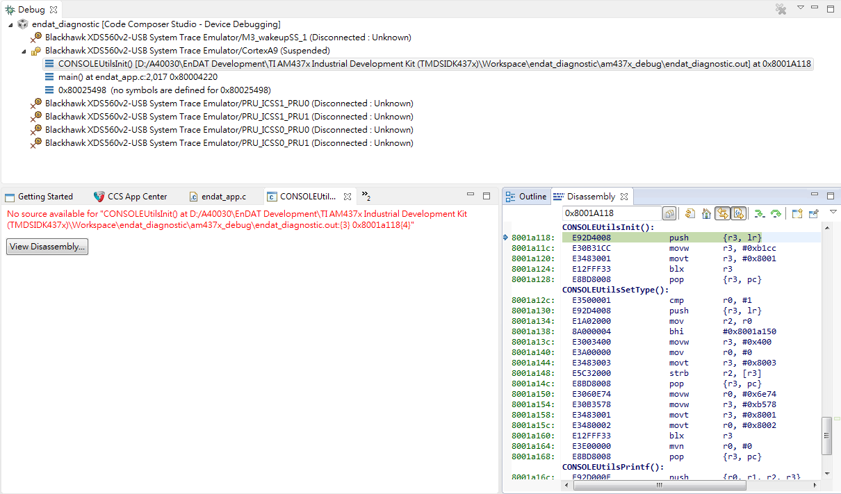

    I check disassembly window.
    When program runs into CONSOLEUtilsInit(), CCS will tell me "No source available for CONSOLEUtilsInit()"

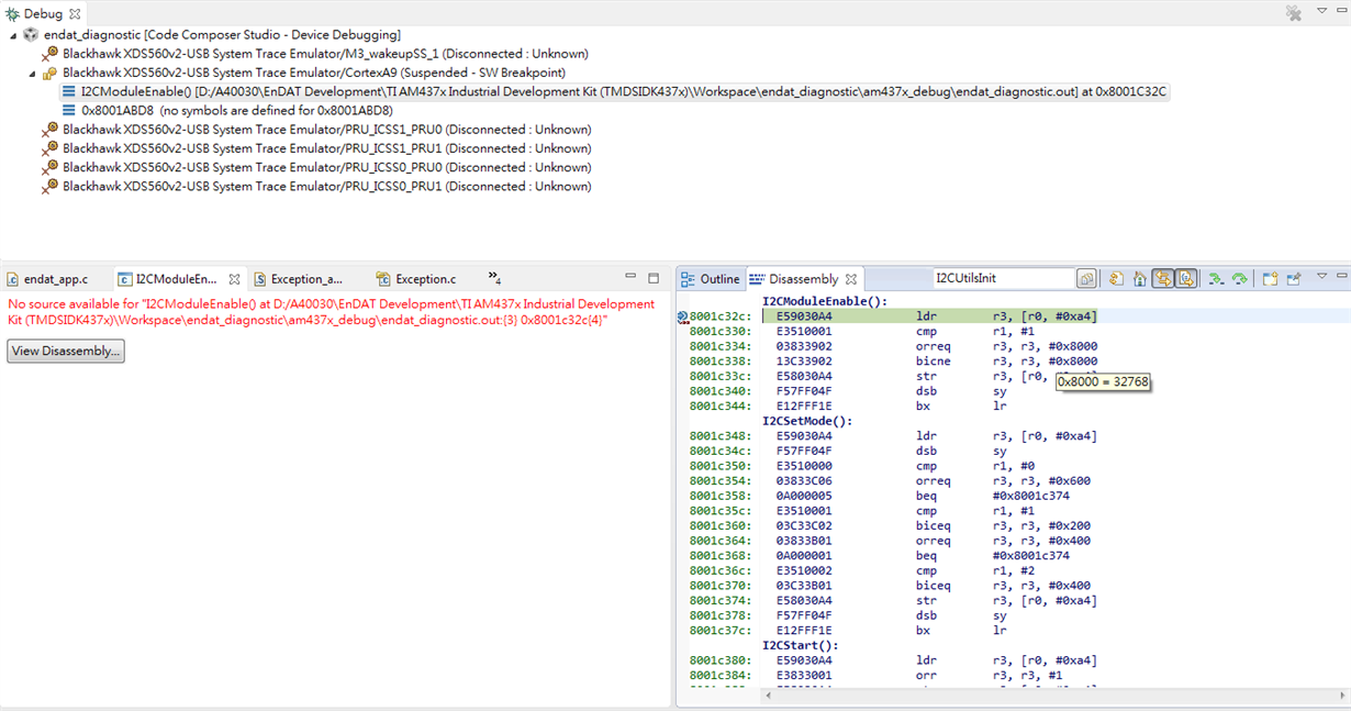

    I use Assembly step into to trace the code step by step on Disassembly window.
    When step into I2CModuleEnable(), the program will immediately jump to address 0x80056010.
    And then get into ti_sysbios_family_arm_exc_Exception_excHandlerDataAsm__I.
    Seems like something going wrong in I2CModuleEnable()

  • Hi Yi-Lin, when CCS shows "No source available for CONSOLEUtilsInit()" you have the option to add a path to the file.
    Searching ISDK 2.1.3.2 I found the paths for these two functions are:
    C:\TI\sysbios_ind_sdk_02.01.03.02\sdk\starterware\dal\i2c.c
    C:\TI\sysbios_ind_sdk_02.01.03.02\sdk\starterware\utils\console_utils.c
    If you add the paths you can keep steeping into functions

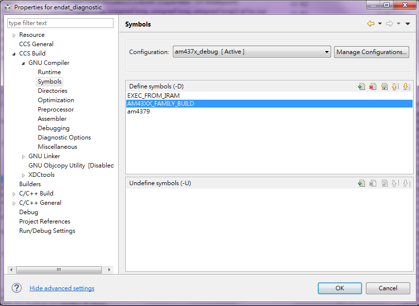

    The program will get into ti_sysbios_family_arm_exc_Exception_excHandlerDataAsm__I() when running for loop in BOARDGetDeviceCtrlModInstNum() (board.c line 541)
    I guess this exception might be cause by the symbol AM43XX_FAMILY_BUILD did not be define.
    Let pBoardData get NULL value from BOARDGetData() function.
    So I add AM43XX_FAMILY_BUILD to define symbols.
    And the program will step into ti_sysbios_family_arm_exc_Exception_excHandlerDataAsm__I()  agin, when running HW_WR_FIELD32_RAW() (hw_types.h line 387) in I2CModuleEnable() .
    Is there any configuration need to be set but I miss?

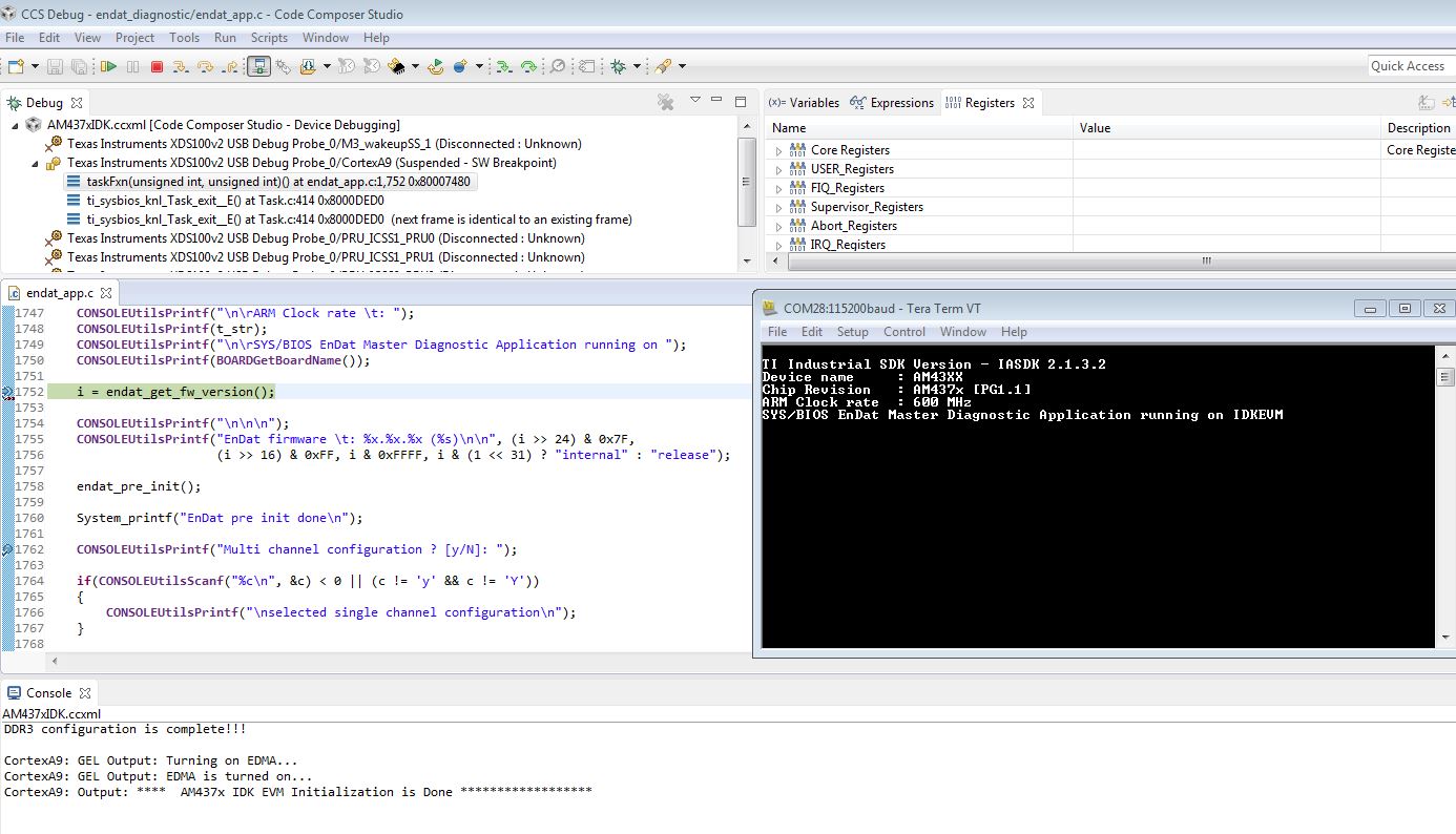

    If you are using an The AM4379 IDK has a USB connector for an XDS100 Emulator interface. The interface is implemented with a FT2232HL.  The FT2232HL also supports a UART interface.  When we use the XDS100 interface this UART port is used to provide console output using a terminal emulator program like teraterm/ hyperterminal/ minicom. This is what is meant by the 2nd paragraph in User Guide's EnDat Diagnostic section .
    "This application is controlled with a terminal interface using a serial over USB connection between the PC host and the EVM. Please connect a USB cable between the PC and the EVM. A serial terminal application (like teraterm/ hyperterminal/ minicom) is then run on the host. To configure, select the serial port corresponding to the port emulated over USB by the EVM."
    Then - Instead of using the Blackhawk USB560v2 System Trace for JTAG -  connect a USB cable from your PC to the board and use the XDS 100 v2 emulator that is on the AM4379 IDK .  Power up the AM4379 IDK.
    To configure the serial terminal application , select the serial port corresponding to the port emulated over USB by the EVM. The host serial port should be configured to 115200 baud, no parity, 1 stop bit and no flow control.
    Using CCS connect to the A9 and load the example program, If you have to reset the board close the terminal emulation and repeat the serial port connection and configuration.
    Place a breakpoint around line 1752 and run the program . You should see something like.
    David
  • Hi David,
    I delete and re-import the example project again.
    Connect the USB to my computer, use XDS 100v2 emulator for JTAG, Tera Term for serial terminal.
    I add a breakpoint at  line 1752  in endat_app.c
    but the program won't stop at that breakpoint, nothing be print at serial terminal.

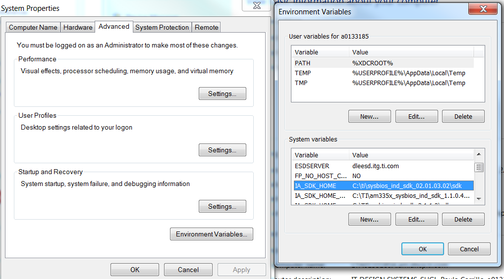

  • Hi Yi-Lin,  quick question, is your PC environmental variable "IA_SDK_HOME" set correctly? below example
    thank you,
    Paula
  • Hi Yi-Lin
    Paula is making a very good point. This IA_SDK_HOME is used throughout the project. We need to set it as an environmental variable. This is documented in http://processors.wiki.ti.com/index.php/SYSBIOS_Industrial_SDK_02.01.03_User_Guide#SDK_Setup
    The process that we recommend to build a project is under  http://processors.wiki.ti.com/index.php/SYSBIOS_Industrial_SDK_Getting_Started_Guide#Building_and_Running_Sample_Application
    The debugger input is the USB connector on the AM437x IDK board. Nothing is connected to the JTAG port.
