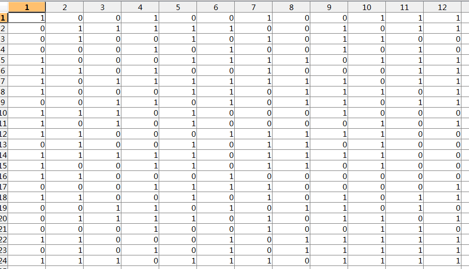

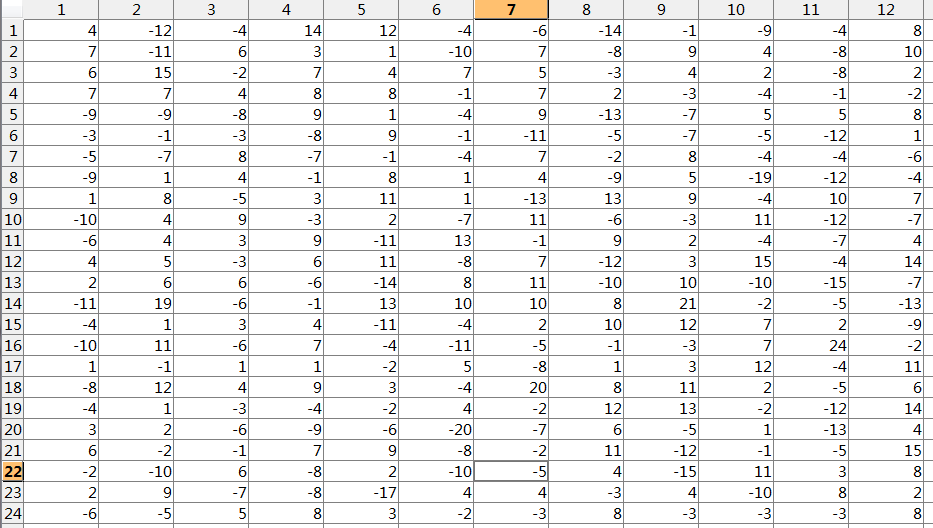

i'm testing bcp_testproject in PDK 6670 about test_lte_ul to decode PUSCH.
i modify the bcp config,delete the RD Submodule to look the result of ssl.
ssl config is
if (radioStd == Bcp_RadioStd_LTE)
        pSslHdrCfg->modeSelCfg.split_mode_en       =   numLayers-1;
        pSslHdrCfg->modeSelCfg.jack_bit            =   0;
        pSslHdrCfg->modeSelCfg.lte_descrambler_en  =   1;
        pSslHdrCfg->modeSelCfg.mod_type_sel        =   (Bcp_ModulationType) (mod/2);
        pSslHdrCfg->modeSelCfg.cmux_ln             =   (Bcp_CmuxLength) (numOFDMSymPerSubfrm - 9);
        pSslHdrCfg->modeSelCfg.q_format            =   (Bcp_QFormat) (Qfmt);
  Rprime1 = 12 * prbList[Rprime] * numLayers;
        pSslHdrCfg->modeSelCfg.b_matrix_sel        =   gind_row_index(Rprime1 * mod);
        pSslHdrCfg->modeSelCfg.rmux_ln_index       =   Rprime;
        pSslHdrCfg->ri_ln               =   0;//numRi;-------modified
        pSslHdrCfg->ack_ln              =   0;//numAck;------modified
        pSslHdrCfg->cinit_p2            =   cinit;
the result is 288 bytes .(descramble_LLR=)
and then ,i disable the descrambler
pSslHdrCfg->modeSelCfg.lte_descrambler_en  =   0;
the result is (undescramble_LLR=)
I use matlab generate the scramble code  according to lte 36.211 is (cinit=115948)
how the ssl descramble the LLR?
    descramble_LLR=(1-2*scramble_code)*undescramble_LLR.
