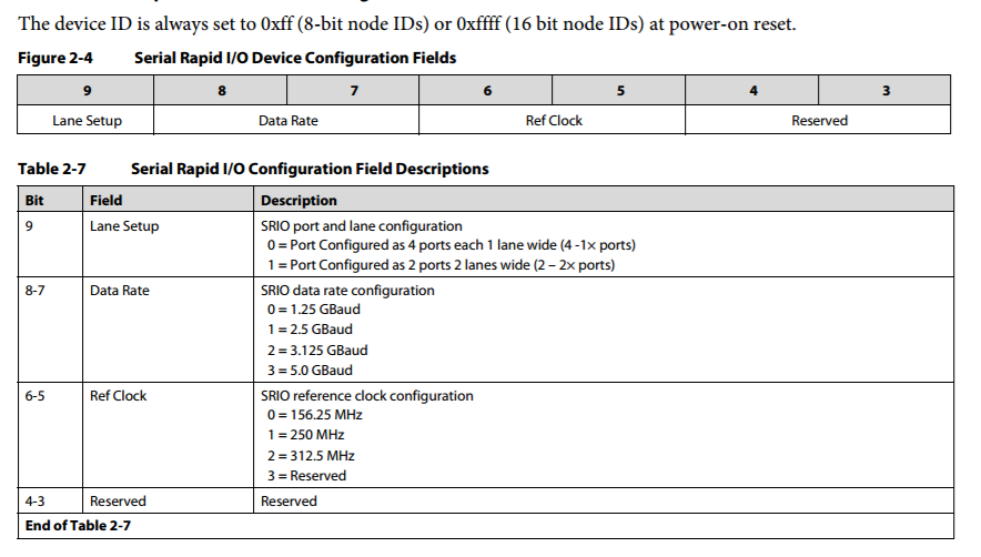

  • The following region in L2 memory is used for the SRIO messages:
    Here are the bits in DEVSTAT (BOOTMODE[15:0]) that are used for the node IDs
    If it is 2 lane then the node ID is 0xFF and if it is 4 lane then it is oxFFFF
  • Rahul,
    Thanks for your reply, but as for node ID, The ROM code does not say so;
    Here is a snippet from rom code (rev2.0) and it initializes the boot parameter table on POR.
    void bootInitBootParamsRapidIo (BOOT_PARAMS_RIO_T *params)
    UINT32 pll;
    params->boot_mode = BOOT_MODE_RAPIDIO;
    params->length = (UINT16) (CHIP_WORDS_TO_BYTES(sizeof(BOOT_PARAMS_RIO_T)));
    params->checksum = 0;
    params->portNum = chipGetDefaultRapidIoPortNum ();
    pll = chipGetDefaultRapidIoPll ();
    params->swPllCfg_msw = chipUpper16 (pll);
    params->swPllCfg_lsw = chipLower16 (pll);
    params->options = chipGetDefaultRapidIoOpts_NonSec (); /* non-secure device use master mode as default */
    params->lane_port_setup = chipGetDefaultRapidIoLanePortSetup ();
    params->cfg_index = chipGetDefaultRapidIoIndex ();
    params->node_id = chipGetDefaultRapidIoNodeId ();
    chipGetDefaultRapidIoSetup(&params->serdes_ref_clk, &params->link_rate);
    params->pf_low = chipGetDefaultRapidIoPfLow ();
    params->pf_high = chipGetDefaultRapidIoPfHigh ();
    } /* bootInitBootParamsRapidIo */
    The above red code sets params->node_id to 0xFFFF.  chipGetDefaultRapidIoNodeId() is defined like this;
    #define chipGetDefaultRapidIoNodeId()       0xffff
    You say BOOTMODE[9](lane setup, 4-1x port or 2-2x port) is related to node id, but it seems this part is related to the above blue code. No relation ship for node_id. Can you clarify ?
    Naoki

    Also, my understanding is any 1x port can accept incoming boot image from the SRIO host device if we setup BOOTMODE[9] as 0. Correct, right ?
    Naoki
  • Your understanding is correct the BOOTMODE[9] relates to chipGetDefaultRapidIoLanePortSetup and not the Node Setup. The SRIO NodeId is always set to 0xffff by the boot ROM. unless an alternate Boot parameter table with different Node ID is provided.
    Yes, the 4 lanes can be used together or individually so any 1X port can can accept incoming data.
