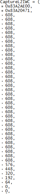

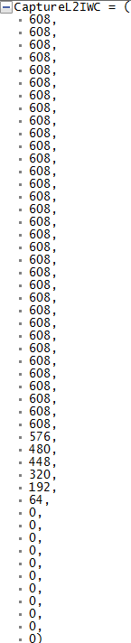

    Would you please try this to capture some early values of L2IWC?
    int CaptureL2IWC[50];
    CACHE_L2IBAR = (uint32_t)&stDataFile[ui8DataFileIndex].stData;
    CACHE_L2IWC = 600; //19200/32
    for ( int i = 0; i < 50; i++ )
    CaptureL2IWC[i] = CACHE_L2IWC;
    while(CACHE_L2IWC != 0);
    Then take a look at the CaptureL2IWC array to see what the early values are, please?

  • Hi RandyP
    Here is the result:
    I wonder why the initial value is 608 and not 600. The data should be aligned at 128.

  • Hi RandyP
    Sorry for the delayed answer.
    RandyP said:
    Please put (uint32_t)stData in the first location of the array so we can see it, or if the compiler prefers, put (uint32_t)&stData[0]. Also, please put (uint32_t)CACHE_L2IBAR in the second location of the array.
    For reference:
    CACHE_L2IBAR = (uint32_t)&sData;
    CaptureL2IWC[0] = (uint32_t)&stData;
    CaptureL2IWC[1] = CACHE_L2IBAR;
    CACHE_L2IWC = 600;
    for (i = 2; i < 50; i++ )
    The result:
    I'm not sure why the value in index 0 and 1 isn't the same?

  • Thomas,
    The first two entries in CaptureL2IWC are different because you write a different value to L2IBAR that what you wrote to the first entry in the array, sData vs. stData.
    Since the WC register is counting down to 0, the cache is invalidated and that operation is done. There cannot be any more side effects of that cache operation.
    If you are waiting for the IPR bit to be set, then the EDMA operation has completed and all the data has landed. It cannot be continuing after that.
    I do not see any way to make happen what you are describing. There have to be other things going on in your application that are causing this odd behavior, but I do not see how the cache could be a part of it.

  • Thomas,
    Thomas Jespersen93 said:
    That must be an error while editing the post. In my code it's correct.
    If it is correct in your code, then there is something else wrong since the first two values in the array are different. That needs to be debugged.
    We have decided to move the data to none cached memory, which apparently solves the problem but is slower when accessing the data.
    There has to be something else going wrong in your system or code, since the cache should be cleanly invalidated. Attached is a standalone test program that does the several steps you have listed and successfully reads the memory. If you try running it, please report whether you also get correct values - the printf's should show a pre-test checksum, a second array's checksum, then a series of post DMA checksums that are all valid. The checksum is written in assembly and is very fast. The code is ugly and has left-overs from other tests I have run, so a lot of comments and #defines and #if's will have to be ignored.
    I do not find anything wrong with the C6424 cache invalidation hardware. Please try this code and if it works then integrate it into your code.
