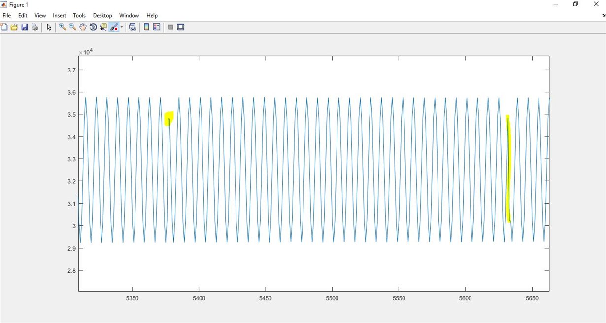

    my code first read aic3204 and after write to file:
    for(n=0;n<30;n++)
        for(index = 0; index < CSL_MMCSD_ATA_BUF_SIZE; index++)
           aic3204_codec_read(&left_input, &right_input); //read aic3204
           mono_input = stereo_to_mono(left_input, right_input);
           gMmcWriteBuf[index] =mono_input+32768;
    /* Write data to the file */
    ATA_seek (pAtaFile, n*CSL_MMCSD_ATA_BUF_SIZE);
    ata_error = ATA_write(pAtaFile, gMmcWriteBuf, CSL_MMCSD_ATA_BUF_SIZE);//write file block data
    printf("FIN\n");
    ATA_close(pAtaFile);
    The result of acquiring a 1000Hz sinusoidal signal is:
    The signal has discontinuities and this is the problem.While writing in file lost samples.(yellow).The loss of samples is every 256 samples, the size of the buffer.
    Looking at the forum people comment that it would be convenient to use the DMA ping pong mode to avoid losing samples, but I am lost in the DMA configuration and implements in my code.
    I need help or suggestion of how to acquire data without losing samples while writing to file.
    Thanks.
