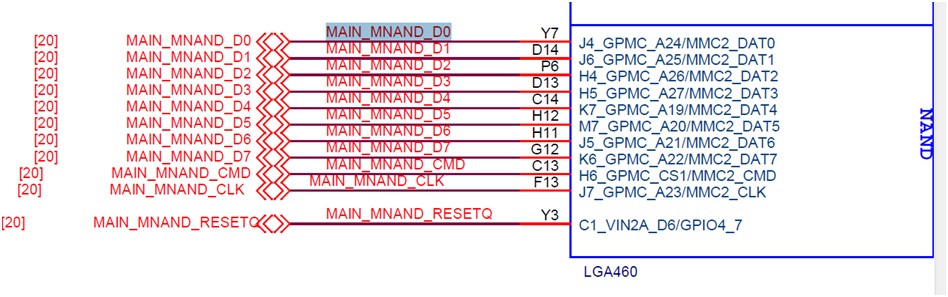

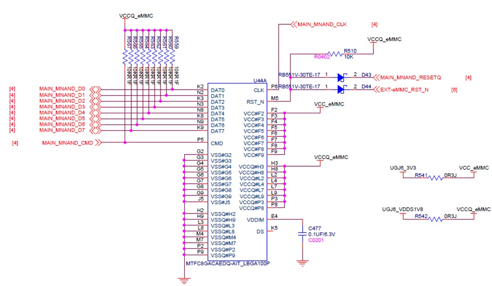

Dear all,
1. I now face a issue with eMMC interface cannot work (error code -110, timeout)
I use SD card, that is, mmcblk0, to boot my develop board, in DTS, it config as &mmc1
I want to access eMMC in my develop board, in DTS, it config as &mmc2
2. Log information as follow:

3. DTS configuration:
&mmc2 {
status = "okay";
vmmc-supply = <&evm_3v3_sw>;
bus-width = <8>;
// pinctrl-names = "default", "hs", "ddr_3_3v";
pinctrl-names = "default";
pinctrl-0 = <&mmc2_pins_default>;
#if 0
pinctrl-1 = <&mmc2_pins_hs>;
pinctrl-2 = <&mmc2_pins_ddr_3_3v &mmc2_iodelay_ddr_3_3v_conf>;
#endif
mmc-ddr-1_8v;
Could you give me some debug way? Thank you for considering my request.
