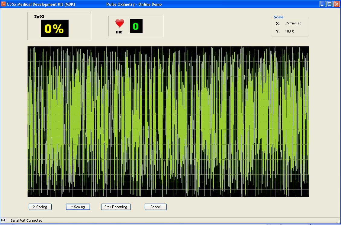

Having successfully compiled the SpO2 MDK codebase (refer to the thread entitled "EVM5515 and Codegen 3.36" for details), I have encountered a disparity between the behavior of the SpO2.out file that is included with the codebase, and that which results from compiling the codebase. In essence, the file that is included with the codebase works perfectly on my 5515EVM target, whilst that which results from compiling the codebase does not. The following screenshot of the PC program shows what is going on reasonably well:
This screenshot was taken with a finger inserted in the Nellcor probe. This noise is also present when the finger is removed.
Are any other 5515EVM / SpO2 MDK users able to confirm this behavior?
