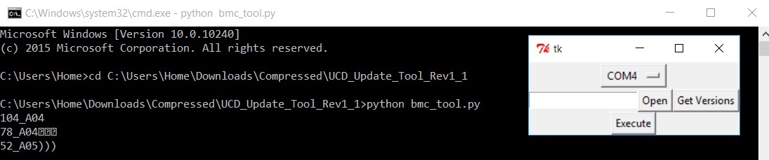

EVMK2H: SOC power failure error
Part Number: EVMK2H
i buy new EVMK2H. when i switch on the board, LCD show "soc power failure". when i looking for a solution i found out that i need to update bmc and ucd. so i program board to bmc version 1.0.2.6 using lm flash programmer. and then i update ucd using boot_tool.py. during update lcd show "main power stop complete" but after that again show "soc power failure". so what should i do?
best regards.
