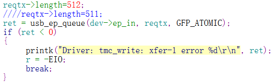

I am programming a usb gadget function driver in the AM3352 customer board
I use the SDK6.0
When i use "usb_ep_queue" API  to send out the data to PC (length 511 or 512)
The USB monitor SW get different results
Length 511 is OK,512 is NG
What is the problem?
Thanks a lot~~

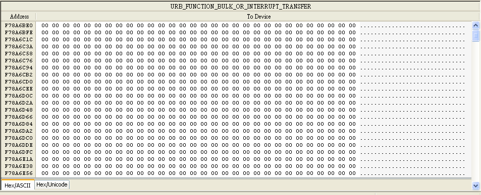

Length is 511
Length is 512
