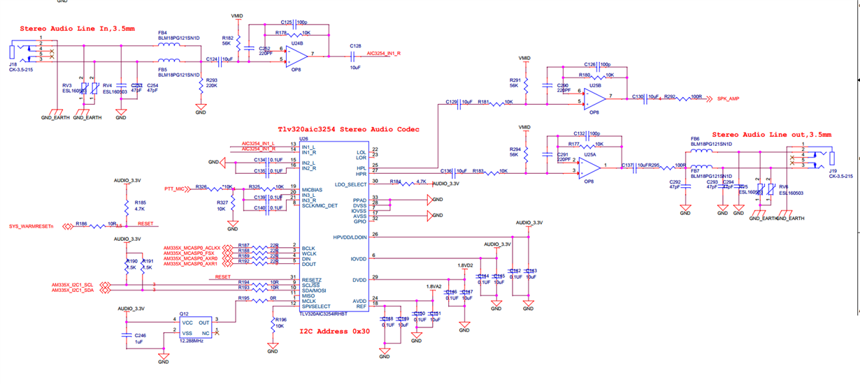

Hi:
     we are developing a customized board based on AM3354.
    our BSP is ti-processor-sdk-linux-am335x-evm-03.02.00.05
     we use tlv320aic3254 as the codec chip and connect it to AM3354 on mcasp0.
the hardware connection of I2S bus is like this:
       AM3354                                                                      TLV320AIC3254
     MCASP0_ACLKX                                                <- BCLK McASP transmit bit clock.
     MCASP0_FSX                                                     <- WCLK McASP transmit frame sync or left/right clock (LRCLK)
     MCASP0_AXR0                                                   -> DIN
     MCASP0_AXR1                                                   <- DOUT
For TLV320AIC3254.We have a microphone connected to IN1L and IN1R. and we have a headphone connected to HPL and HPR of TLV320AIC3254
Here is my dts file configuration:

after booting up the linux.we can see the kernel log like this:
    asoc-simple-card sound: tlv320aic32x4-hifi <-> 48038000.mcasp mapping ok
    ALSA device list:
      #0: AM335x-EVM
and because i found that the alsa-lib and alsa-utils are already in place in the ti sdk rootfs.
without any configuration on asound.conf
i just did this:
root@am335x-evm:/home# aplay -vvv s.wav
Playing WAVE 's.wav' : Signed 16 bit Little Endian, Rate 44100 Hz, Stereo
Plug PCM: Hardware PCM card 0 'tlv320aic32x4' device 0 subdevice 0
Its setup is:
  stream       : PLAYBACK
  access       : RW_INTERLEAVED
  format       : S16_LE
  subformat    : STD
  channels     : 2
  rate         : 44100
  exact rate   : 44100 (44100/1)
  msbits       : 16
  buffer_size  : 22052
  period_size  : 5513
  period_time  : 125011
  tstamp_mode  : NONE
  tstamp_type  : MONOTONIC
  period_step  : 1
  avail_min    : 5513
  period_event : 0
  start_threshold  : 22052
  stop_threshold   : 22052
  silence_threshold: 0
  silence_size : 0
  boundary     : 1445199872
  appl_ptr     : 0
  hw_ptr       : 0
Max peak (11026 samples): 0x00000000 #                    0%
Max peak (11026 samples): 0x00000002 #                    0%
Max peak (11026 samples): 0x00000004 #                    0%
Max peak (11026 samples): 0x00000005 #                    0%
Max peak (64 samples): 0x00000004 #                    0%
aplay: pcm_write:1940: write error: Input/output error
there is no sound coming from the headphone...and after some time.the aplay just stopped with this error  "aplay: pcm_write:1940: write error: Input/output error"

  • I'm also attaching the schematic here just for your reference

  • Hi Yordan:
         Because the power supply of aic3254 is not connected to our PMIC tps65910.It's connected to a fixed LDO .And the power can't be turned off once the main power supply is on.
         So that i removed all the content in aic32x4_setup_regulators() and aic32x4_disable_regulators() in the tlv320aic32x4.c with regulator_enable() and regulator_disable() APIs.
         Otherwise the tlv320aic32x4.c wil checked if i have defined things about power supply in dts and will pop out error when initializing like "Missing supply 'dv' or 'ldoin"
         The same thing happens when the driver is reporting this error when initializing:
    "tlv320aic32x4 1-0018: Failed getting the mclk. The current implementation does not support the usage of this codec without mclk"
    because as is shown in the previous message with the schematic attached...Our mclk is connected directly to a osc of 12.288MHz.Thus is not generated by AM3354 as well.
    So based on this reason i also removed all the clk_prepare_enable() APIs in tlv320aic32x4.c.
    thanks for the suggestion!

    Hi Yordan:
          thanks for helping confirming that the hw and dts is correct.
           the kernel log is attached above.Please check.. It seems i can't find anything strange in the kernel start log.Please help me check this.
          I will look at "Sitara Linux Audio DAC Example" for details.thanks.
          i'm suspecting something but please correct me if i'm wrong:
          because both BCLK and WCLK are all clock signals generated by AIC3254. And then feed to AM3354.Right?
          so since i see no signal at all on i2s bus when playing music.Is it possible that the AIC3254 is not configured properly to work ?
          So there might be something need to be changed in code (tlv320aic32x4.c or maybe simple-card.c?)?
          thanks for the help.
    regards
    semiyd
    Bootlog seems fine. This should be something with the alsa machine layer, or the alsa integration in the linux file system.
    Check your code against the wiki first.
    Yordan
  • Hi Yordan
        thanks.
       i'll look into it and get back!
