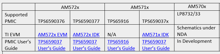

Common question from customers:
What are the PMICs recommended for AM57x family?
Part Number: AM5728
Please see the table located in the schematic checklist for the latest recommendations:
http://processors.wiki.ti.com/index.php/AM57xx_Schematic_Checklist#Power
The links are also clickable in the wiki.
