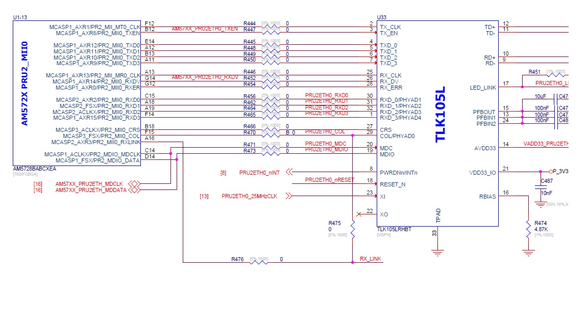

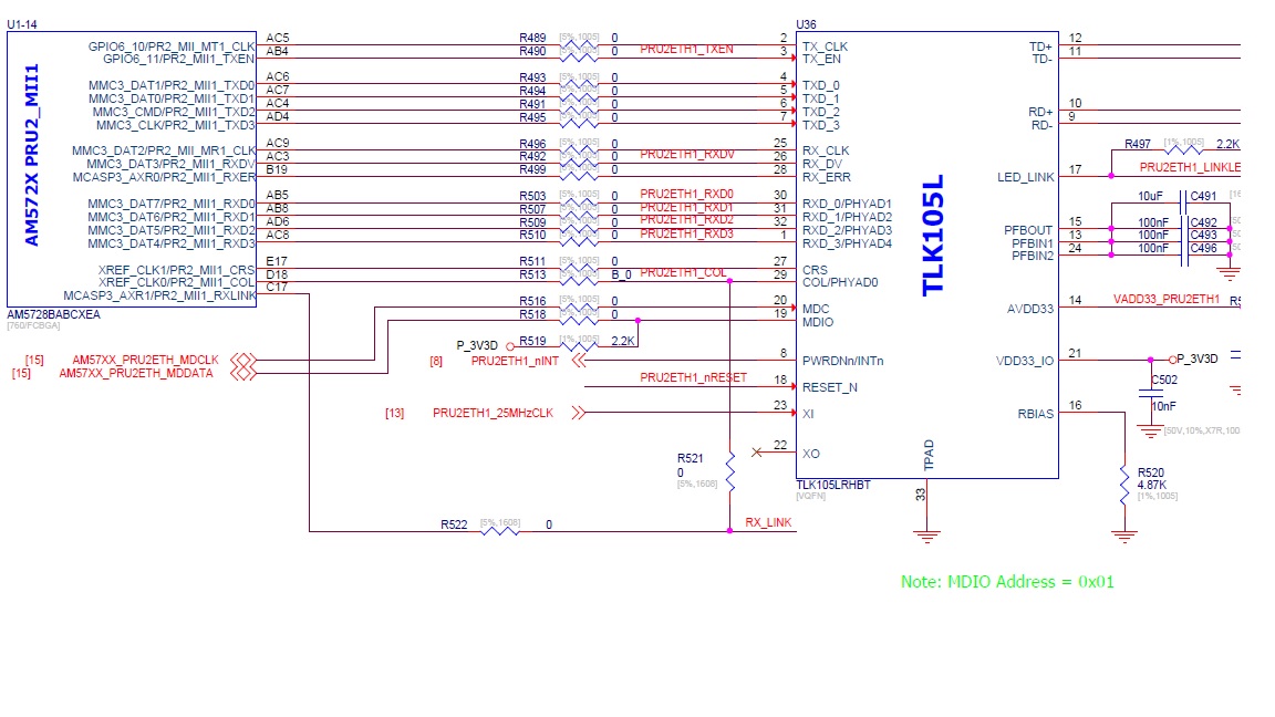

I have custom board same as AM572x-IDK ( H/W & S/W same ).
And TLK105L connected PRU2 ETH0 / ETH1.
But, RCSR Register value is different ........ My board and AM572x - IDK.
and PRU2 ETH1 phy chip is not working..on my board.
In AM572x-IDK PRU2 ETH0 , ETH1 phy chip mode are "MII" Mode (RCSR(0x17): 0x41)
In My Board PRU2 ETH0 Setting is "MII" Mode.
But PRU2 ETH1 Setting is "RMII" Mode.
I don't know why PRU2 ETH1 Set "RMII" Mode .
I Check the Pin Level about "RX_DV."
No Pull up Register RX_DV pin &  internal pull-down RX_DV
this log is my custom board.

My board H/W Connection
