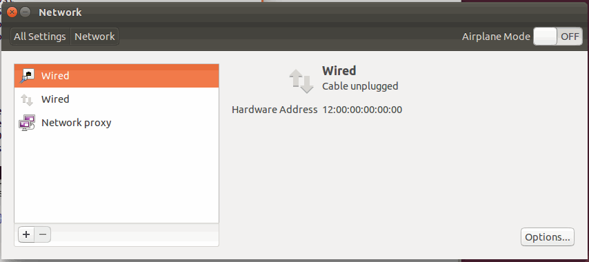

I'm working on a device based on BeagleBone black and ti-processor-sdk-linux-am335x-evm-01.00.00.03. and have problem with getting the USB working.
I'm using the attached script and it works fine with Windows host. However, it has problem in linux. The host machine detects my device but it does not assign an ip number.
user@ubuntu:~$ ifconfig
usb0      Link encap:Ethernet  HWaddr 12:00:00:00:00:00
          UP BROADCAST MULTICAST  MTU:1500  Metric:1
          RX packets:0 errors:0 dropped:0 overruns:0 frame:0
          TX packets:1 errors:0 dropped:0 overruns:0 carrier:0
          collisions:0 txqueuelen:1000
          RX bytes:0 (0.0 B)  TX bytes:90 (90.0 B)
The network settings dialog show the device but it says the cable is not plugged in.
Could some one help me figure out what is going on?
Thank you
Brian

  • Hi Brian,
    Have you verified that both board & host pc use stitc ip settings or dhcp?
    Yordan
  • My device uses 192.168.7.2 as its static IP and has DHCPD configured to give 192.168.7.1 to the host. This works under windows.
    When I force set the IP to 192.168.7.1 on linux host it still does not work.

  • Hi Brian,
    How have you connected the host and the device through LAN? or Are they directly connected via ethernet(one end to device and the other end to host) ?
    What is the ifconfig in the device ?
    If you set dhcpd(this means dhcp server, which gives IP to others, then why static config), what is the IP range in the settings ?
  • "How have you connected the host and the device through LAN? or Are they directly connected via ethernet(one end to device and the other end to host) ?"
    The device is on a lan and both the host and the device are connected to the same ethernet hub.

  • Hi Brian,
    I missed out that USB ether is being used. So have you tried:
    1. making cdc_only in cecdev.txt script ?
    2. Can you make sure udhcpc in host is using usb0 interface if using udhcpd in device side ?
    3. You can also give a try of ifconfig eth0 down and check in both device and host.
  • Forcing making cdc_only in the script make it work. What does it mean? Does it mean that I can't have support for both Linux and Windows at the same time?
  • It turned out that using RNDIS only, without CDC, works fine on Windows host and Linux host. Doh!!!
