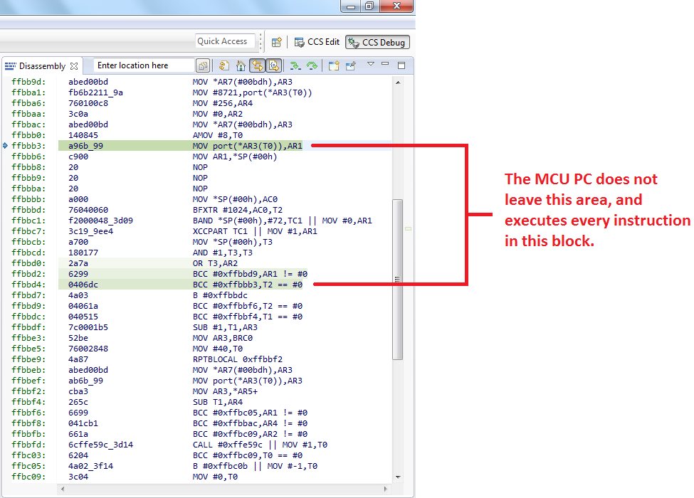

  • Hi Lali,
    Yes, we do have 12.1K pull ups on all 6 SD Card pins (CLK, CMD and data pins).
    The debug session I performed had the PC stuck between addresses 0xFFBBB3 to 0xFFBBD4 (see below picture).
    Ben
  • Hi Ben,
    The screenshot did not come through the reply. Can you please re-post? Thanks.
    Lali
  • I'm trying to post the picture again, it didn't take in the previous post.
  • Also, here is the schematic for the SD Card Interface.

  • Hi Ben,
    Glad that it started working with the different format tool.
    The C55xx bootloader only supports the single partitioned SD card. The SD card formatter from SD card association formatted the SD card into single partition by default, while the Window’s formatter keesp whatever partition is by default,
    If the SD card was formatted as multiple partitions, then it will not work with the C55xx bootloader.
    Lali

  • Hi Lali,
    I was able to read the MBR from a good known working SD card and a SD card that caused the bootloader to stall.
    It would seem that there is garbage data in the partition section of the SD card that causes the bootloader to stall.
    On the working SD card there is only one partition present.
