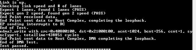

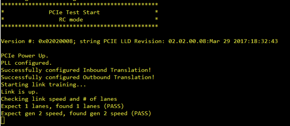

    Yes, I did the throughput between two AM572X IDK EVMs connected throughput PCIE cable. Note we only have GEN2x1. In theory half of your bandwidth.
    I used the P-SDK Rel 3.3 PCIE example code, but I think earlier code should have the same results. I ran the test on DSP at 600MHz. I made the following changes:
    1) In   PcieExampleEdmaRC() or PcieExampleEdmaEP(), I simply did a hard coded:
    CCount = 1;
     ACount = 1024;
     BCount = 256;
    Otherwise the EDMA transfer size is controller by PCIE_EXAMPLE_LINE_SIZE. Based on current code, the EDMA destination buffer is in L2 of DSP, which only has 288KB. So my 256KB transfer is good.
    2) I also changed EDMA sync from A-sync to AB-sync edmaTransfer(hEdma,(EDMA3_Type) EDMA_TYPE, (unsigned int*) source, (unsigned int*) remoteBuf,
                  ACount, BCount, CCount, EDMA3_DRV_SYNC_AB,totalTimePointer);
    It is easier for me to set break-point in edma3_test() to see how many cycles spend. Otherwise, there is (i = 0; i < numenabled; i++) loop for me to add up.
    I simply flipped source and destination for EDMA read test. The cycle count for read and write are almost the same (~440000 cycles).
    Below is my number (WRITE case):
    From math: 256 * 1024 /440000 *0.6 = 357MB/s. This is almost the theortical. I don't feel an issue in AM572x. Do you have any way to measure the FPGA to FPGA PCIE throughput?

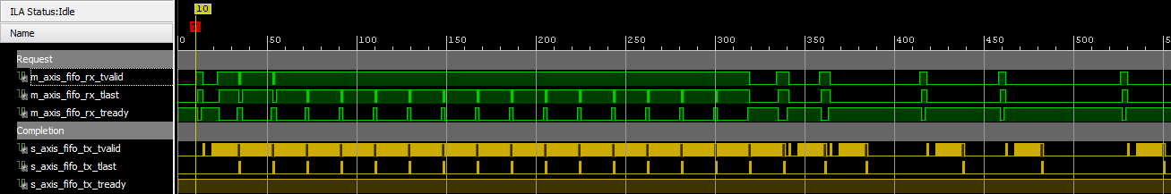

    We did some research on the fpga side and what we see is a stall of read request TLPs from the sitara that limits the bandwidth to 600MB/s. I would like to understand where this stall is coming from.
    On the fpga probe we see 16 request TLPs coming in in a burst. The fpga immediately starts responding from the first TLP on. After 16 request TLPs the time between incoming TLPs gets longer.
    Her one can see in the upper three rows the incoming request TLPs and in the lower three rows the response. Following a description of all signals showing:
    Request
    1. High: there is incoming TLP data pending
    2. High: the last available TLP data is ready to be read
    3. High: the following pipeline is ready to receive the next TLP
    Completion
    1. High: there is outgoing TLP data
    2. High: the last data word of the TLP is ready to be read
    3. High: the transmit side of the PCIe core is ready to read incoming data
    It is obvious that for the first 16 TLPs the FPGA transmit side is stalling (signal m_axis_fifo_rx_tready is low). The first TLP gets handeld immediately but the following are handled with a delay.
    But after these TLPs the incoming TLP fifo dries out (clock cycle 320 in the picture). Now the following pipeline is able to compute the TLPs immediately again. It's waiting most of the time for incoming TLPs.
    Since the PCIe core is 3rd party IP we don't know the implementation details but additionally to the probe in the picture we have done a time correlation via GPIO and we can see that in the beginning the incoming TLP rate is high enough to ensure maximum bandwidth - around 50ns per TLP.
    We did some diagnostics regarding flow control / TLP credentials on the fpga side and we can't see any unusual/suspecting. We simply can't sort out what makes the sitara sending the following TLPs in such a slow rate - around 200ns per TLP.
    Do you have any thoughts about it?

    Sorry for the late response! In this case, AM57x is the requestor which sending out reading request TLP to FPGA. You saw that after 16 burst TLP then the TLP interval is bigger which made the throughput lower. I reached out our HW team and I have no clue. In your eariler post "It's now at 285MB/s with 1x lane and around 600MB/s with 2x lanes. Note that with 2x lanes it's a bit more than double the rate with 1x lane. This is much better and meets our lowest estimated requirements." So I hope this number still acceptable in your system requirement.
    The TLP ACK frequency is controlled by Table 24-871. PCIECTRL_PL_ACK_FREQ_ASPM (offset 0x70C). By default this is 0. You may program this to a small number N to see if ACK DLLP is generated every N TLP and to see increase to a bigger N has any benefit to generate read TLP faster on AM57x.
    Regards, Eric

    The timeline in the diagram I sent is measured in FPGA clock cycles. One cycle is 4ns and the first 16 TLPs need around 310 cycles. This results in one TLP needing around 77ns. With 64 bytes per TLP we get a theoretical bandwidth of 787MBytes/s.
    After the first 16 TLPs one TLP needs around 50 clock cycles -> 200ns which results in a theoretical Bandwidth of 305MBytes/s.
    The real world data rate depends on the ratio between slow and fast paced TLPs. Since we can only probe a limited time slice we don't know if there are later on more fast paced TLPs and how often they occur. But we see a stable Bandwidth on huge requests of 600MB/s. The diagram gives a hint that there is a bandwidth of around 780MB/s possible.
    The numbers here are all more or less rough estimations but they should be correct in magnitude.
           Tim
    Thanks! So seeems there high pace at 787MB/s and low pace 305MB/s making a stable 600MB/s PCIE read. I don't have a theory why this happens or if we can sustain a higher rate like PCIE write. I wild guess is that the PCIE on AM572x has some receiver buffer, the data reading in needs to be moved into the designated memory region to free the buffer, before EDMA request more data from FPGA.
