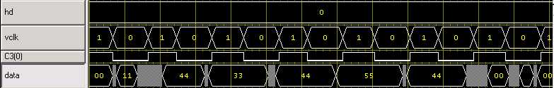

    - the issue is data pattern  observed on the analyzer. Please see below details
    2) Fixed pattern  : Different data for UYVY (alternate values of U and V are different)
    Data send by DSP : 00 11 22 33 44 55 66 77 00 11 22 33 44 55 66 77  ............................................... 00 11 22 33 44 55 66 77
    Expected o/p        : 00 11 22 33 44 55 66 77 00 11 22 33 44 55 66 77  ............................................... 00 11 22 33 44 55 66 77
    We have observed that when UV data is getting changed, U2 appears in V1 place and we are not getting V component at all. Also we can see some data fluctuations (e.g. between data 11 and 44 or 33 and 44 etc) in same clock. Is this expected output? (vclk and c3(0) are same waveforms)

    As we discussed offline, the following suggestions would solve the issue. I am listing them here so that this post can have the relevant answers availablae. Please confirm and close this thread once you verify the solutions.
    1. Modify YCCCTL.CHM bit to 1
    2. Modify YCCCTL.REC656 bit to 1
    Please refer to page 46 of the VPBE PRG which tells that YUV422 data is converted to YUV44 data and is then sent out on digital interface as YUV422 based on the setting of CHM.
    If CHM=0, Cr data sent out on the bus is calculated as follows
    Cr1 = (Cr0+Cr2)/2
    Cr3 = (Cr2+Cr4)/2.........
    The data going out on the bus goes as follows:
    Cb0 Y0 Cr1 Y1 Cb2 Y2 Cr3 Y3.....
    If CHM=1, data goes out as follows:
    Cb0 Y0 Cr0 Y1 Cb2 Y2 Cr2 Y2........., which is what you were looking for.
