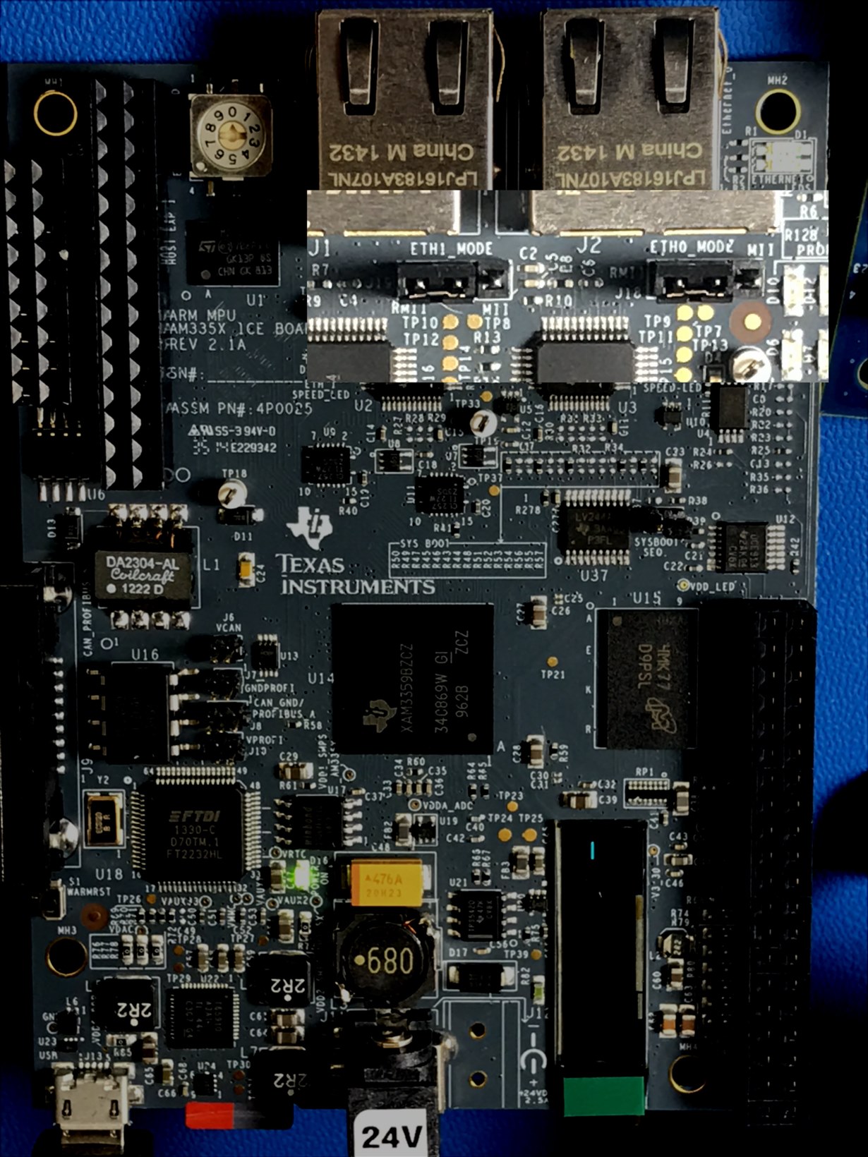

I've been following the "Processor SDK Linux Getting Started Guide" to get our TMDSICE3359 evaluation board running.  I've successfully created an SD card using the create-sdcard.sh script.
When I run the setup.sh script, I'm choosing to use TFTP as my kernel location, and NFS as my file system location.  In minicom, I can see the script being executed correctly.  However, when I try to boot the board, I see the following:

I'm still trying to become familiar with the whole development environment, but is the "Unable to read file uEnv.txt" message something I should be concerned about, or possibly what might be causing my problems?
