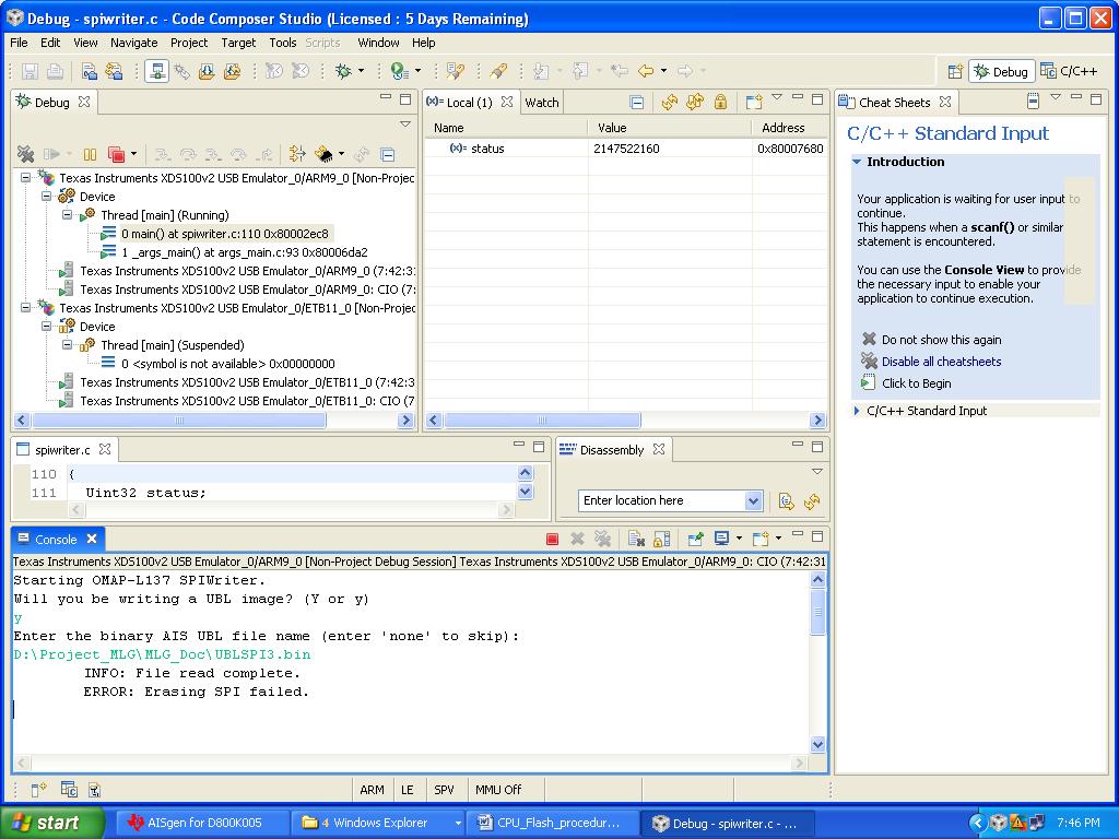

We have made a custom AM1705 board with IC Part Number AM1705DPTPA3 and are using SPI flash for booting. Flash IC part No is Macronix MX25L25635E.
We are using Code Composer Studio v4 and XDS100v2 TI 14-pin JTAG Emulator Part No TMDSEMU100V2U-14T for writing the SPI flash
In the ROM bootloader version check of our AM1705 IC the memory view is displaying text d800k005
 I have downloaded the OMAP-L137_FlashAndBootUtils_2_40.tar.gz and loaded the spiwrite.out file created from the above CCSv4 project & run the code.
then the spiwrite application ask for ARM UBL file, then when I load the ARM UBL provided by OMAP-L137_FlashAndBootUtils_2_40.tar.gz  then it gave me " Error : Erasing SPI failed " as shown in the Pic below
Which SPI writer should be use or any modifications are needed to be done for writing the SPI flash on the custom AM1705 board ?
Please help me to solve the above issue.

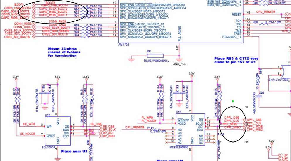

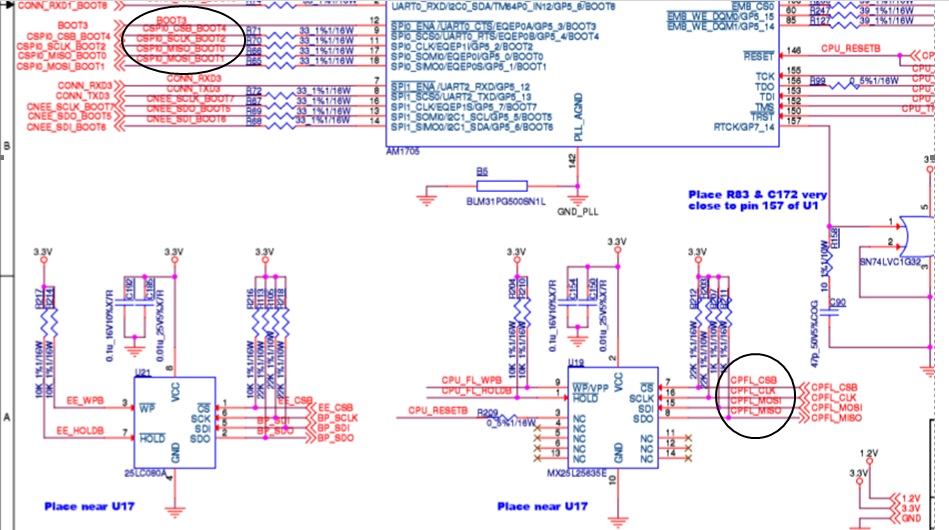

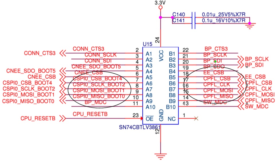

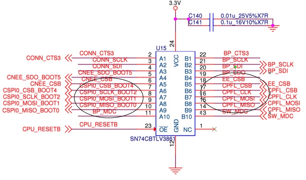

  • Hi Rahul,
    As per your suggestion we have compared the spi_mem.h file with flash datasheet and we found that the commands are same.
    The Flash MX25L25635E on our board is connected with SPI0 port of the AM1705 in 4-pin mode i.e SPI_CS, SPI_CLK, SPI_MOSI, SPI_MISO. The Hold, Write_protect, Reset pin of the AM1705 are pulled up to 3.3V.
    The AM1705 IC is configured in JTAG mode by keeping the Boot pins 0,1,2,3,7 as 0,1,0,0,1 respectively as per given in the AM17XX bootloader application notes
    In the CCSv4 tool we build the project using the OMAP137 Boot and flash Utilities files and connected our custom AM1705 board with the PC
    While doing the above operation we monitored and tried to capture the SPI_CS and SPI_CLK signal coming out of the AM1705 IC on the board using the oscilloscope, but we did not see the SPI_CS signal going low.
    Actually we have our custom older version boards with AM1705BPTP3 (part now obsolete) which has the same flash with same schematic and circuit on which if we try to write the spi , it gets successfully written, but in the new board we have the latest AM1705DPTPA3 IC with which we are getting this errors
    Please suggest some solution
    Thanks and Regards,
    Sandesh

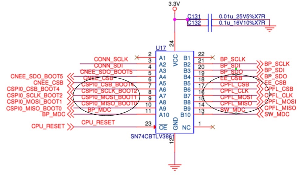

  • Hi Rahul, Senthil,
    Thanks for replying
    From hardware point of view
    1. There is a pull up on the SPI0_CS pin in the new board same as in older version board. The pull up resistor value is 22Kohm
    2. We have 2 numbers of newer version board and we are getting same error on both the boards
    3. The SPI0 port on the AM1705 is dedicated to the SPI Flash only and it is not multiplex to any other SPI peripheral or GPIO
    Schematic for new board
    Schematic for older board

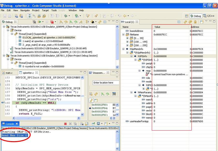

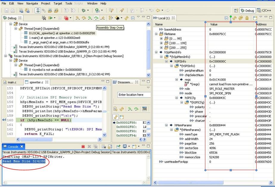

    On the firmware side, we tried to debug and run the code in step by step using the Code Composer Studio,
    Here is what we are getting the issue
    Board with new version
    and Board with older version
    Please reply
    Sandesh

  • Hi Senthil, Rahul,
    I removed the Pull up from the SPI_CS pin and tried to program the SPI flash,
    this time also it did not get programmed.
    It seems that the AM1705 is getting hanged during programming because it did not even showed the message  of  "Erasing SPI failed"
    We added debugs in the code before and after the spi erase function to debug the issue, but the code was getting stuck before the erase operation and it did proceed further. (The file read operations before erasing use to get  successful i.e "file read complete")
    I tried it programming the newer version board many times but every time the AM1705 processor use to get hanged before erase operation and the CCSv4 software use to stay in Running mode for long time untill we terminate the operations
    But the we could see the same debugs in our older version board  which has the AM1705B,

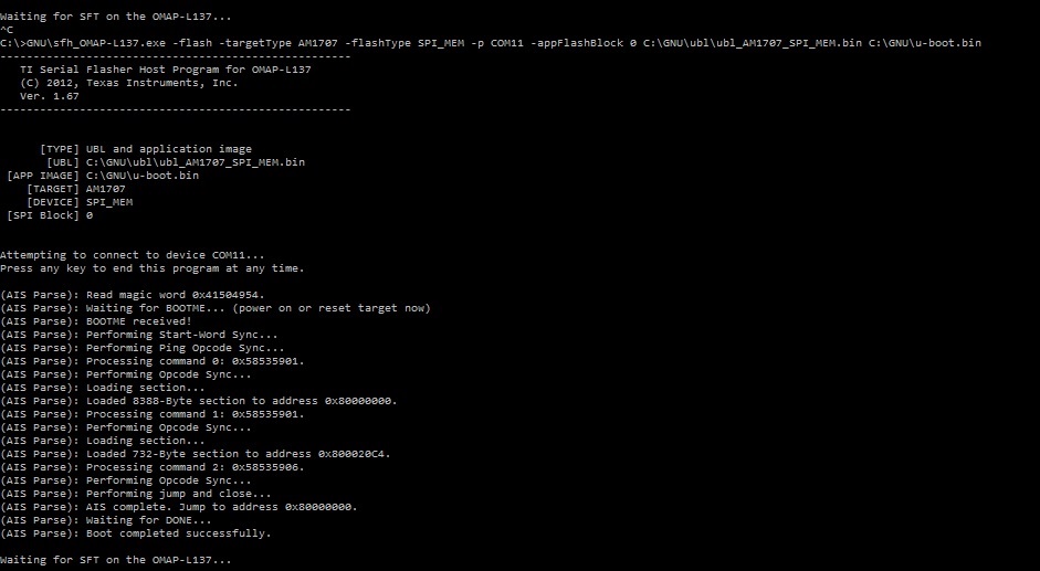

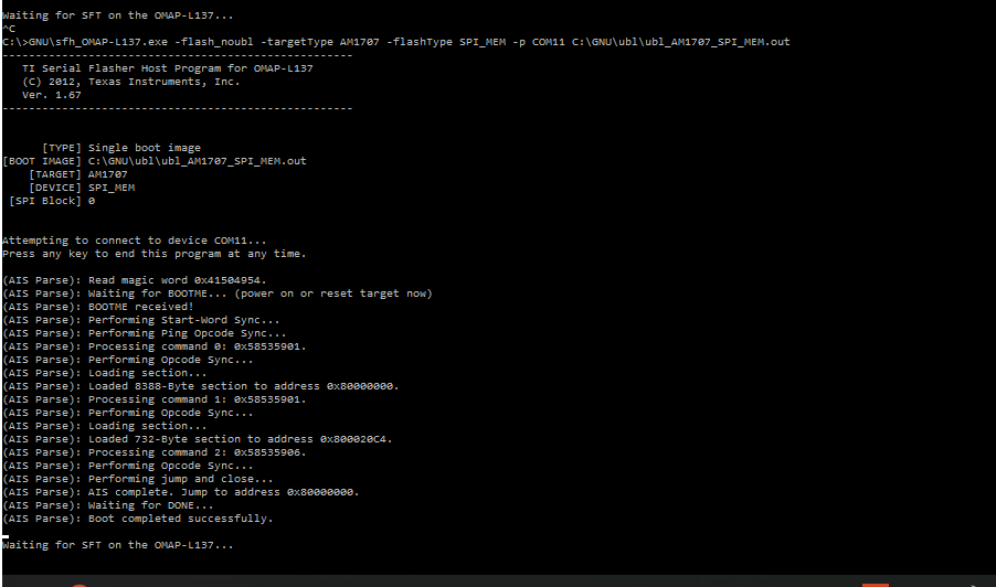

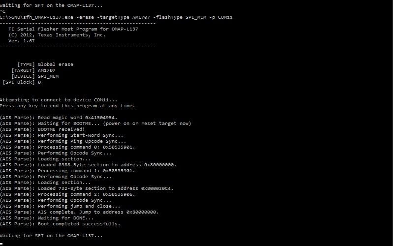

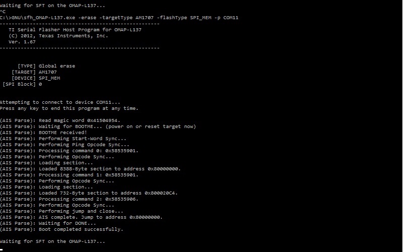

  • Hi Senthil,
    As per your suggestion I tried SFH Utility to write the image into the flash
    Here are few images
    The above operations are getting halted at the " waiting for SFT on the OMAP-L137..."
    At the end lines of all the above 3 operations it is saying Boot completed successfully for which just for confiming while doing the above operations, I tried to monitor the SPI0 signals of the AM1705D IC on which the flash is connected using oscilloscope specially the SPI0_CLK signal, but I did not see any waveforms or clk signals coming out of the AM1705D IC,
    So I am confused whether the flash is really getting erased and written using the serial flash writer or not?
    Please reply
    Thanks & Regards
    Sandesh
