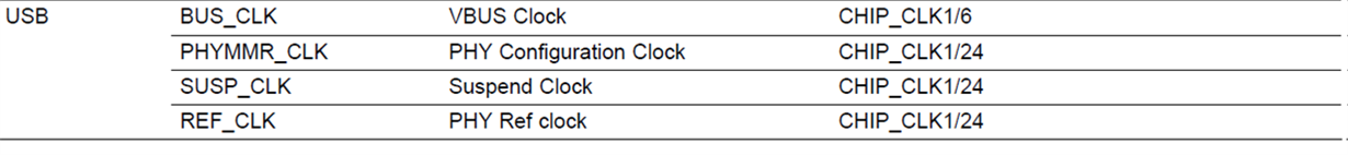

Q2: Can I leave USB0_XO and USB1_XO unconnected? The 5.9.3.1 in data sheet of K2G says “ USB0_XO / USB1_XO - optional USB0_PHY / USB1_PHY reference clock input.” I plan to use NSS PLL for USB PHY reference clock. Is it ok?"
