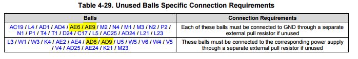

Dear Champs,
Could you please confirm if datasheet is right for unused pin?
I'm confused as I found a difference between datasheet and ICE board.
I found below unused pins should be connected to GND when 1 x 16bit DDR3 used,
But, I found DDR3_DQS2_P(AE6), and DQS3_P(AE9) are connected to DVDD_DDR and DDR3_DQS2_N(AD6) and DDR3_DQS3_N(AD9) are connected to GND in ICE board schematic.
Could you please let me know what is correct?
Thanks and Best Regards,
SI.
    Use the data manual recommendations. The rule is to connect *_N pins to power supply & *_P pins to GND, as described in the datasheet.
    Yordan

    For DDR_CLK, DDR_CLK_N(AD24) is connected to GND, and DDR_CLK_P(AE24) is connected to VCC according to Table 4-29.

  • Hi SI,
    Also follow the data manual on these pins. The pull up/pull down for the differential inputs are mainly to keep these signals in a steady state and avoid any chatter on the lines. This will avoid any extraneous clock signals inside the K2G.

    I'm still confused and want to double confirm Table 4-29 again.
    For DDR3_DQS, in datasheet Table 4-29, it is said DDR3_DQS_P is connected to GND, and DDR3_DQS_N is connected to VCC. But, also in datasheet Table 4-29, it is said DDR_CLK_P is connected to VCC, and DDR_CLK_N is connected to GND.
    I want to check this again because there is no coherence and DDR3_DQS_P is connected to VCC and DDR3_DQS_N is connected to GND in ICE board schematic.

  • Hi SI,
    The thing to remember is that these are differential signals. Pulling one side up and one side down will hold the input in a stable state. For clocks and DQS it doesn't matter which side is up and which side is down.
