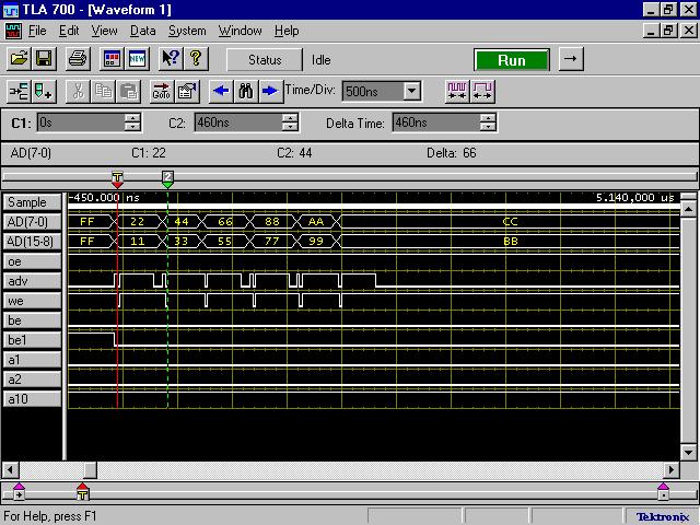

I am trying to do an 8-word burst write to a generic SRAM-type interface from the OMAP35x GPMC, but cannot tell from Figure 11-21 in the SPRUF98 how to use nBE[1:0] to get the data.  Can someone shed some light on this or point me to a document that describes this in more detail.  Thanks

  • Jeff-
    Thanks for your responsiveness.  Perhaps I didn't explain well enough.  I would like to receive a burst of 8 16-bit words into my FPGA using the multiplexed address/data mode.  In order to do so, I need to increment an address pointer for each new data word, but it is unclear how the nBE signals change for this type of transaction.  Do they toggle for 16-bit writes?  If so, do they simply binary count from 00 to 11 (twice through for an 8 word burst)?  I cannot simply increment the pointer at each successive clock since Figure 11-21 shows D0 being present on the bus for several clocks, D1-D6 are present for one GPMC_CLK each, and D7 is present for two GPMC_CLKs. Hope that clarifies my question.  Thanks again for your help.

  • Hello John,
    I didn't figure it was that easy, but I thought I would give it a shot :)
    For 16b writes nBE0 and nBE1 do not toggle, so nBE is not a good signal to use for this.  I would try using WE.  I have attached a capture of the GPMC setup in 16b mode with the ARM writing multiple words.

  • Jeff-
    Thanks for the picture. That was really helpful. Can you answer another question for me on the GPMC? It seems that we're trying to do a single read from a register in our target device, but the reads always come back as a 32 word burst read. Any thoughts on what may cause that? You can read more detail on the problem from my coworker here:
