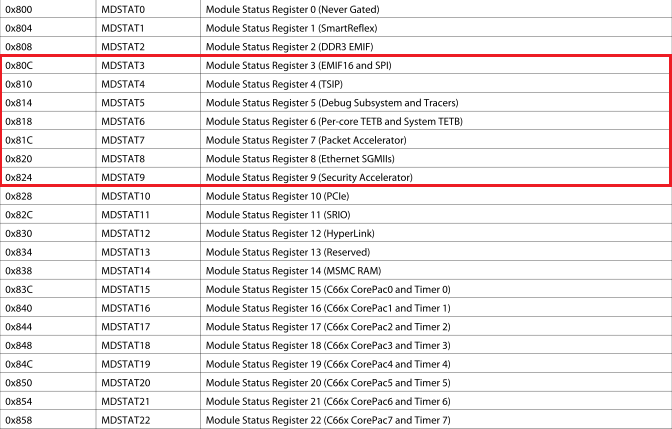

TMS320C6678: PSC default value after reset
Part Number: TMS320C6678
"3.2 Peripheral Selection After Device Reset" in datasheet (SPRS691E) describes the PSC default value after reset.
 - By default, the PCIe, SRIO, and HyperLink are held in reset and clock-gated.
 - All other modules come up enabled by default and there is no special software sequence to enable.
I checked the PSC registers in TMDXEVM6678LE Rev 1.0 which is configured in No boot, PCIESSEN=0 and no GEL file. It shows that some other modules are held in reset and clock-gated.
Are these values correct as the default value after reset?
