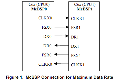

We're working on a design where one L138 needs to communicate with four C6474 DSPs. I found a great apnote about McBSP to McBSP communications which will be the starting point for the code. The appnote ties the Rx side of one McBSP to the Tx Side of the other McBSP and reverse:
As I'm trying to communicate from the L138  to multiple C6474s (the C6474s don't talk to each other, the L138 only talks to 1 C6474 at a time), I need to implement some kind of bus-switch. This way, at any point in time only 1 of the C6474s McBSP is connected to the L138 McBSP. An interrupt line per C6474 to the L138 allows the C6474s to signal they have something to say.

3) Assuming the former statement is correct, to implement a bus switch, I only have to switch (gate) the signals going from each C6474 to the L138 and the FSX line to the C6474s right?
    Based on your connection diagram, your understanding is correct.
