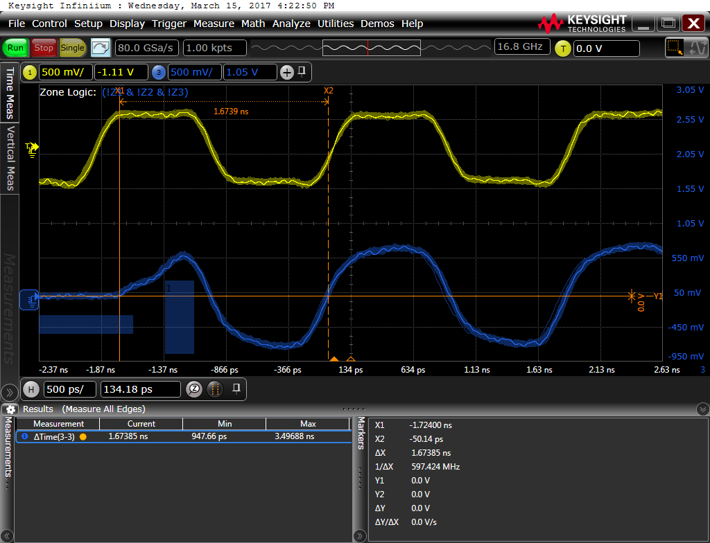

Our customer fails in a timing of tWPRE of DDR3 compliance test of AM572x.
A start of DQS of the tWPRE section is late, and it does not satisfy min of tWPRE(0.9*tck).
Please confirm the following wave pattern.
Yellow: CK signal
Blue: DQS signal
The following countermeasures were taken, but in both cases the timing of tWPRE did not satisfy spec.

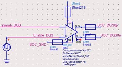

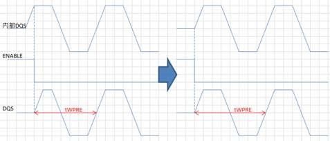

    From the IBIS model of AM5718, the internal circuit of the DQS buffer is as follows
    There seems to be an ENABLE signal outputting the internal DQS to the outside.
    Adjust the timing to put this ENABLE signal and as shown below DQS
    Will not the tWPRE increase as early as the beginning of the rise?
    Please let me know if there is a register to set the timing to insert this ENABLE signal.

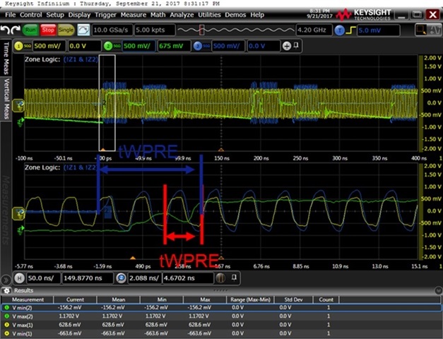

  • Hi Siva,
    Thank you for various support.
    According to your answer, DQ1 was added and measured, it turned out that the timing confirmed as tWPRE was different.
    For details, please refer to the following.
    We have the following two questions.
    ① Which of red and blue will be the timing of tWPRE?
    ② For tWPRE, is it the specification of AM57xx that DQS starts high / low switching operation before the original write preamble period?
    Measurement result:

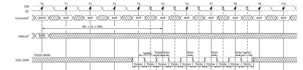

  • Tsuda-san
    Please see the snapshots below. Basically, the tWPRE should be measured - Basically, one clock cycle before the actual WRITE DQ input to the DRAM is when you should be measuring the tWPRE. From your scope capture, I'm unable to figure out when the actual WRITE command is sent to the DRAM to determine the right clock edge for tWPRE measurement. Please refer to your memory data sheet which should provide information about how to measure tWPRE for different scenarios.
  • Tsuda-san
    Please see the snapshot below. Basically, one clock cycle before the actual WRITE DQ input to the DRAM is when you should be measuring the tWPRE. From your scope capture, I'm unable to figure out when the actual WRITE command is sent to the DRAM to determine the right clock edge for tWPRE measurement. Please refer to your memory data sheet which should provide information about how to measure tWPRE for different scenarios.
    Regards, Siva
  • Hi Siva,
    Thank you for quick reply.
    The failure problem of this time is caused by a change in the DQS signal before the correct tWPRE and the measuring instrument regarded the change as tWPRE.
    Could you tell me the answer for the following?
    Shigehiro Tsuda

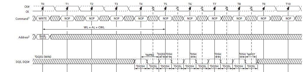

    From WL=AL+CWL=0+6=6, 18.8nsx6=11.28ns from issuance of write command to output of write data.
    (Operating frequency is 532 MHz)
    On the waveform this time roughly matched the time from WE=L to the leading rise waveform of DQS.
    It seems that timing of min 0.9 * tck or more of DDR3L tWPRE is not observed. For details, please check the following.
