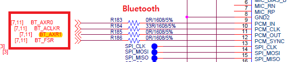

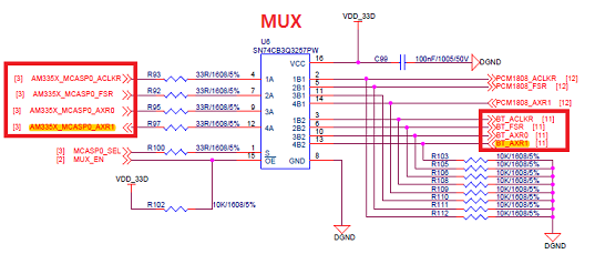

 Hello.
I am trying to record I2S streaming data using ALSA lib. ( arecord -f S24_LE -r44100 -c2 -D hw:0 test.wav )
When I play the record file, it has too much noise.
Please check my arecord command and MCASP register configuration.
thank you.
- Block
- Bluetooth I2S bit format
- Device tree

    SW fragment seems ok.
    Have you checked your hw connections? Is it possible to play a sound (some other .wav file)?
    Do you get any errors upon device bootup? Please share the bootlog (dmesg).
    Yordan

    Thanks for your reply. Here is my boot log.
    And, it is impossible to check play at MCASP0, but I check play wav file through MCASP1.(it was OK)
    My full feature is below.
    Thank you
    PS I want to attach my recorded wav file. But I don't know how to upload file.
