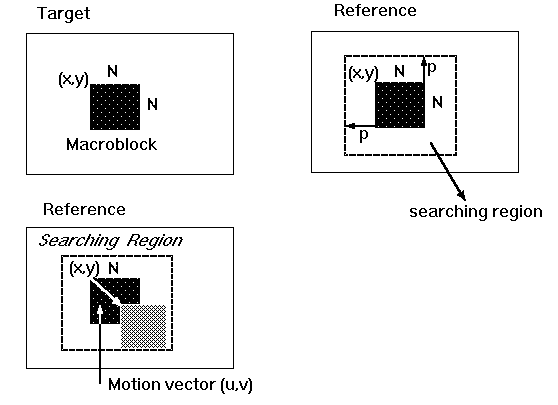

    2. i want to find out the direction from the Mv's. How can i achieve it, as the Mv's are based upom each macro block. are we getting 1 MVx and MVy cordinate based upon the best SAD value of each Macroblock ?
  • Hi Sujit,
    Regarding 1: With +/- 29.75 I mean in integer pel. The MVs returned by ME will be in quarter pel. So the limit is (+/- 29.75 x 4) = 119.
    Regarding 2: The MVs returned are in macro block (MB) basis. The dump contains 1 MVx and MVy per MB based on least SAD position for that MB.
    Rgds, mahant

  • Mahant
    one more question. the what is the macro block search happens ?
    i mean the search area, is it like +/- 16 MB's as with reference MB or +/-8 or how many ?
  • Hi Sujit,
    I am not aware of any specific algorithm for detecting the motion direction.
    Inverse tan might be a simple approach, but it depends on the application requirement i.e. with what accuracy you want the direction. I'll let you know if I can think of something on this.
    I didn't get the question in your latest post. Can you re-state it?
    Rgds, mahant
  • there is typo mistake in my post. may be because of thaquestion was not clear.
    my point is while searching the best match macroblock, what is the serch region?
    how many macroblocks are serached in each direction to find a best match.
  • Hi Sujit,
    As indicated in my previous post (same thread),
    In the horizontal direction we search +/- 32 pixels and +/- 14 pixels in vertical direction.In vertical direction we make use of global motion vectors thereby dynamic vertical search range will be higher.
    Same data can be interpreted in terms of MBs.
    Rgds, mahant
