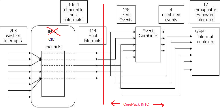

    In CPINTC module function of particular interest is CSL_CPINTC_mapSystemIntrToChannel. Consider diagram:
    As I understand, calling CSL_CPINTC_mapSystemIntrToChannel() makes connection between System Event to Channel, which in C6670 is equivalent to Host Interrupt. In other words we link System Event input to CIC output. My doubt is how this channel/HostInt is related with CorePack's input. Particularly, where number of 114 HostInt comes from? In TMS320C66x DSP CorePac User Guide, Table 9-2 System Event Mapping I see available events mapping, these are ranges 4-8, 10, 15-95, 99, 102-109, 112, 114-115, total 108 if I counted right. Please explain about this mapping.
    Thanks in advance.
  • Well, perhaps I found little hint. In C6670 data manual I see table Table 7-38 System Event Mapping — C66x CorePac Primary Interrupts. And these are fixed event mappings. Among them I see
    Event Number  Interrupt  Event Description
    56            CIC0_OUT0  Interrupt Controller output
    57            CIC0_OUT1  Interrupt Controller output
    So I guess, when I map to channel 0 of CIC, it arrives as primary event 56 and so on. Is it correct?
    And next, if I want system event, like EDMACC0 to route through CIC, then though Event combiner - how do I achieve that? In CIC I need to map event 36 to 0, which will arrive to CorePack as primary event 56. Next I have to link HWI with combiner output like EventCombiner.eventGroupHwiNum[1] = 8; If so, where do I plug the ISR - at
    EventCombiner.events[56].fxn    = '&edma_isr';
    or at
    CpIntc.sysInts[36].fxn      = '&edma_isr';
    Thanks in advance.
