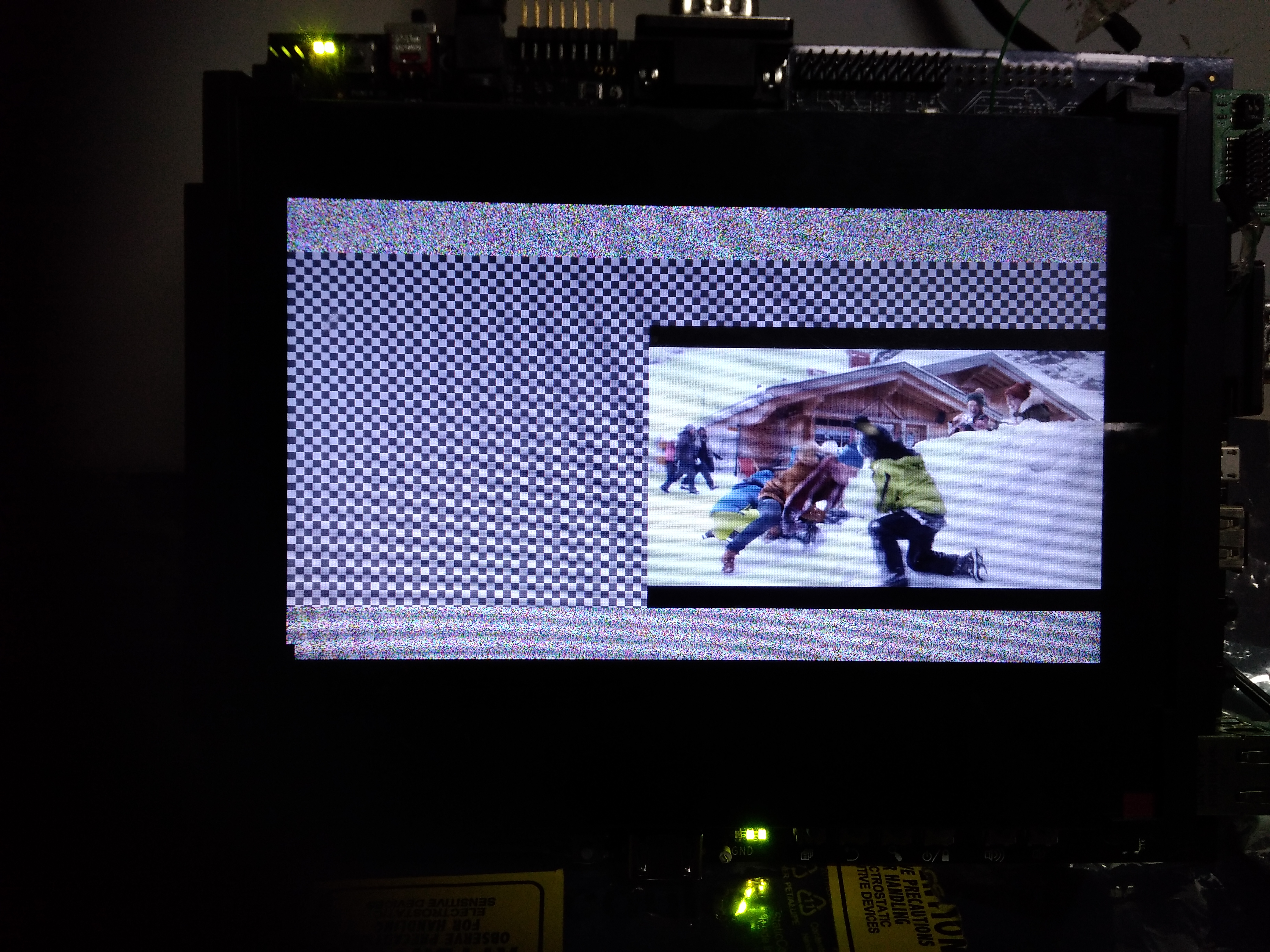

I am using TI sitara EVM 437x. I need to play a mp4 video directly on the frame buffer. For that by stopping weston I run gstreamer pipeline as follow. I am successfully able to run video but it is aligned to center only.
I am using this pipeline : # gst-launch-1.0 -v filesrc location = ./promo_video_small.mp4 ! decodebin ! videoconvert ! videoscale ! video/x-raw,width=450,height=280 ! fbdevsink
here is the output :
by changing value of width and height I can change the video display dimensions.
for shifting video to desired x,y position I tried with following pipeline : # gst-launch-1.0 -v filesrc location = ./promo_video_small.mp4 ! decodebin ! videoconvert ! videobox border-alpha=0 ! videobox alpha=0 left=-450 right=-50 top=0 bottom=0 ! videoscale ! video/x-raw,width=380,height=300 ! fbdevsink device=/dev/fb0
By using this pipeline the video is getting compressed i.e. from left border video shifts to right but right border remains as it is or can shift to left but can not shift further in right direction, and while shifting it  left black box behind video in background having same size of video frame we have given in pipeline.
if I write +value in left and top or any other margin value it crops the image while -value add the pixel this I read somewhere in videobox property.
how to remove this black box shown on left and right side of the video and how to shift the video without affecting its size of video having transparent background.

    The "blackbox" is normal since the default value of the videobox fill property is "black". For example if you use:
    gst-launch-1.0 -v  videotestsrc ! videoconvert ! videobox border-alpha=0 ! videobox alpha=0 left=-450 right=-50 top=0 bottom=0 fill=3 ! videoscale ! video/x-raw,width=380,height=300 ! autovideosink
    it will be red.

  • thank you for your reply yes black is default. but i want transparent there plus the same problem is there video size is getting modify. I dont want it I want to simply shift it. And I am using device's frame buffer directly so can not use autovideosink. This will not display video on fb...

  • yes I know but with the same property I am able to shift in ui but it is not working on framebuffer of TI sitara EVM AM437x. that's why I post to TI
    In your pipeline why you have two videobox elements
    (" videobox border-alpha=0 ! videobox alpha=0 left=-450 right=-50 top=0 bottom=0")?
    Could you try to remove or replace the videoscale element. You could try to move it before the videobox.
    videoscale ! video/x-raw,width=380,height=300 ! videobox alpha=0 left=-450 right=-50 top=0 bottom=0 ! ...
    Let me know do you observe any difference.

  • yaa its working fine.. omg.. Thank you so much. Thanks a lot

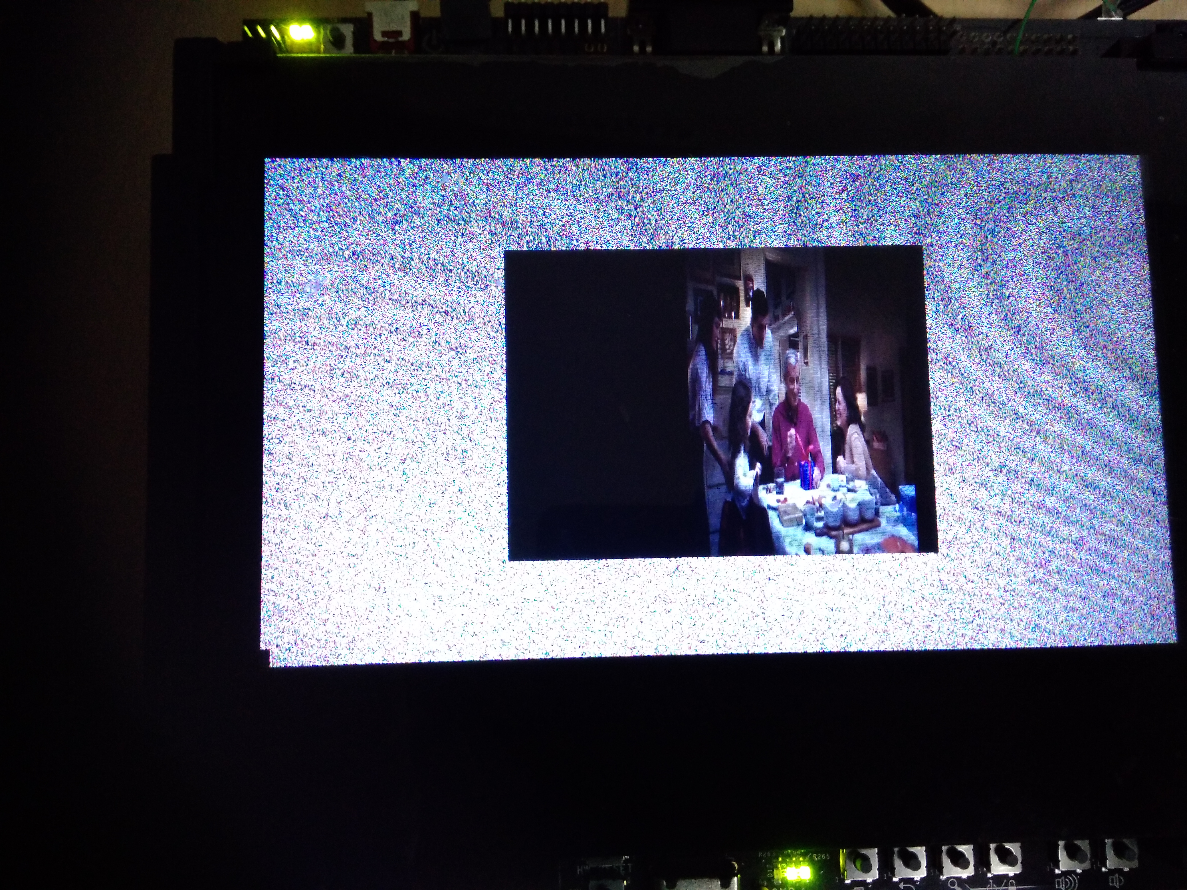

    yes mam I understand this and I am getting background as transparent background we can have while open a any such png image.but it is not transparent. I tried as follow
    gst-launch-1.0 filesrc location = ./promo_video.mp4 ! decodebin ! videoconvert ! alpha ! videoscale ! video/x-raw,width=450,height=300 ! videobox border-alpha=0 left =-350 top=-70 bottom=0 right=0 ! videomixer name=mix ! videoconvert ! fbdevsink
    and the output is :
    here I have fill the background with randome colors first using /dev/urandom
    ma'am my ultimate purpose is to demonstrate video as well as image on same fb. let say any image is already there on screen and over it a video has to play... but image is not fix it may be or may not be... so such kind of background overlay is not acceptable. and image status may vary so I cant use here mixer to stitch image and video.
    I need all the rest background be as it is. so my background image doesn't effect.
    In theory, it seems that if you set the alpha-border property to 0 the border(the black box) should be transparent.
    Are you able to make this border transparent when you executing the pipeline on PC?

  • yes ma'am. but how I explain you it writes the screen with transparent layout image, in this context transparent means no color. but it is not transparent to let us see background.
    ok for example if we take a transparent layer initially it has white and gray boxes right? so this fills such boxes as transparent color. you can zoom out my image and check.
    I am confusing but I hope I am able to convey what problem I am facing.

    About your next reply xpos and y pos property I tried that but not getting any affect. I am getting the same effect as previous one. border fill with transparent pattern square boxes with centre alignment.
