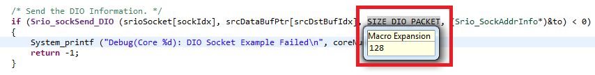

    Q 1:
    for sending 1MB data I should set SIZE_DIO_PACKET to 1MB ?

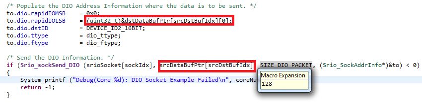

    Q 2:
    Is it possible change source address to local L2 SRAM and destination address to MSMC SRAM?
    I want to make a project in loopback mode that Core1 send data to Core0 by SRIO in DIO mode, Core1 send data from its local L2 SRAM to MSMC SRAM for Core0 and Core0 produce interrupt after receiving
    data.

  • dariush,
    Yes, SIZE_DIO_PACKET can be set up to 1MB, see LSUx_Reg3
    19-0 Byte_Count 19’h0 Number of data bytes to Read/Write - up to 1MB. (Used in conjunction with RapidIO address to create
    WRSIZE/RDSIZE and WDPTR in RapidIO packet header).
    0x0000 — 1MB
    0x0001 — 1B
    0x0010 — 2B
    0xFFFFF — 1048575B
    You should be able to modify source address to local L2 SRAM and destination address to MSMC SRAM. Note the local L2 SRAM is 512KB per core.

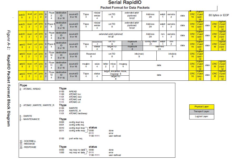

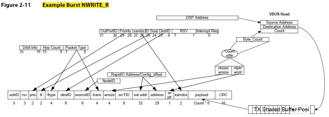

    I have a customized board that contained FPGA and DSP. I want to send data from FPGA to DSP by SRIO.
    I want to FPGA write data in DSP memory. After I studied " sprugw1b.pdf " I decided to use DIO and I run
    " C:\ti\pdk_C6678_1_1_2_6\packages\ti\drv\exampleProjects\SRIO_LoopbackDioIsrexampleproject " examples.
    According to " sprugw1b.pdf " page 63 if packet type is NREAD, NWRITE  ..., the  DSP is in DIO operation mode in
    other words when FPGA send packets including SWRITE,NREAD, NWRITE, DSP received DIO packets.
    Q 1:
    Which field of header in FPGA is responsible  for DSP memory map address?
    I studied " pg007.pdf " in page 168 describe the packet format as below.
    Q 2:
    Which field of frame determine the DSP memory address in the figure 2-11 in " sprugw1b.pdf " as below?
    Q 3:
    Why " WrPtr " is one byte?
    Best  Regards
