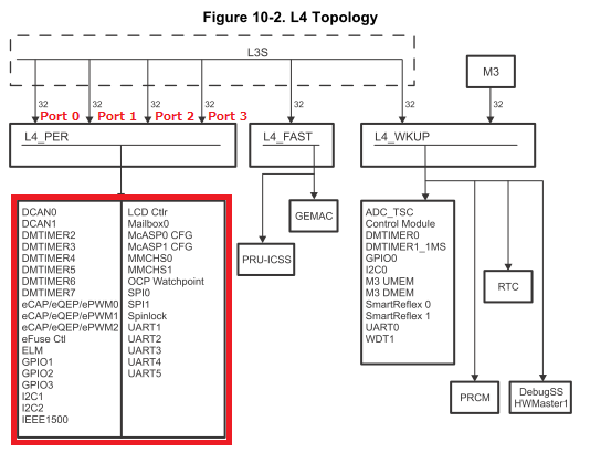

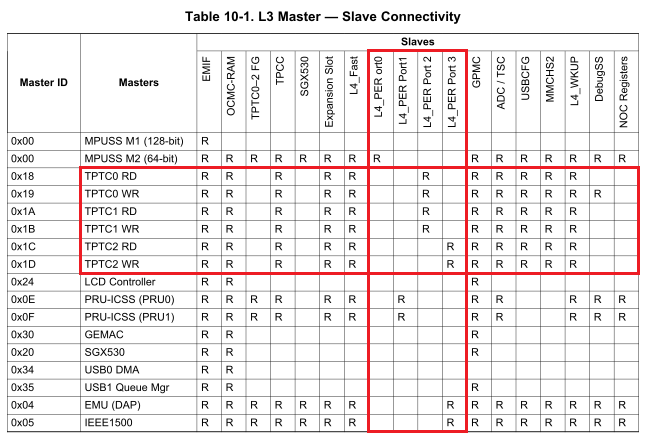

In TRM (SPRUH73P), Table 10-1 shows the required L3 connections between bus masters and slave ports and Figure 10-2 shows the L4 bus architecture and memory-mapped peripherals.
The bus masters access L4_PER through four ports (L4_PER Port 0 to 3) and various peripherals are connected to L4_PER.
Can all peripherals connected to L4_PER be accessed from all of four ports (L4_PER Port 0 to 3)?
Our customer wants to access GPIO registers by EDMA.
