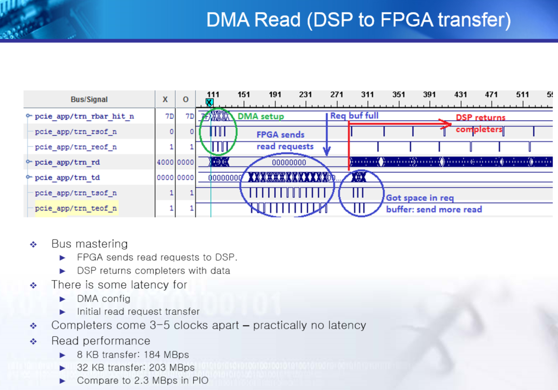

  • Hello Eric,

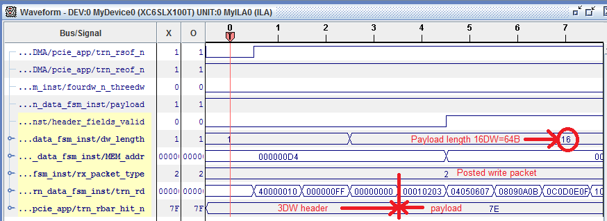

    I have just confirmed my suspicion: zero payload was due to my failure to submit buffer's global address to EDMA engine. See the capture at FPGA transaction  interface
    After 3 DWORDS of TLP Header there is payload as I expected it to see. Mea culpa.

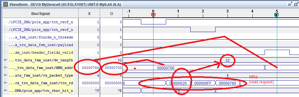

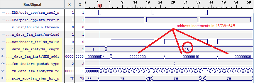

    However, the issue with TLP payload size still there. On the picture above one ma see 'dw_length' signal showing 16DW=64B. In some larger scale:
    Note, MEM_addr signal increments by 0x40, which again is 64B.

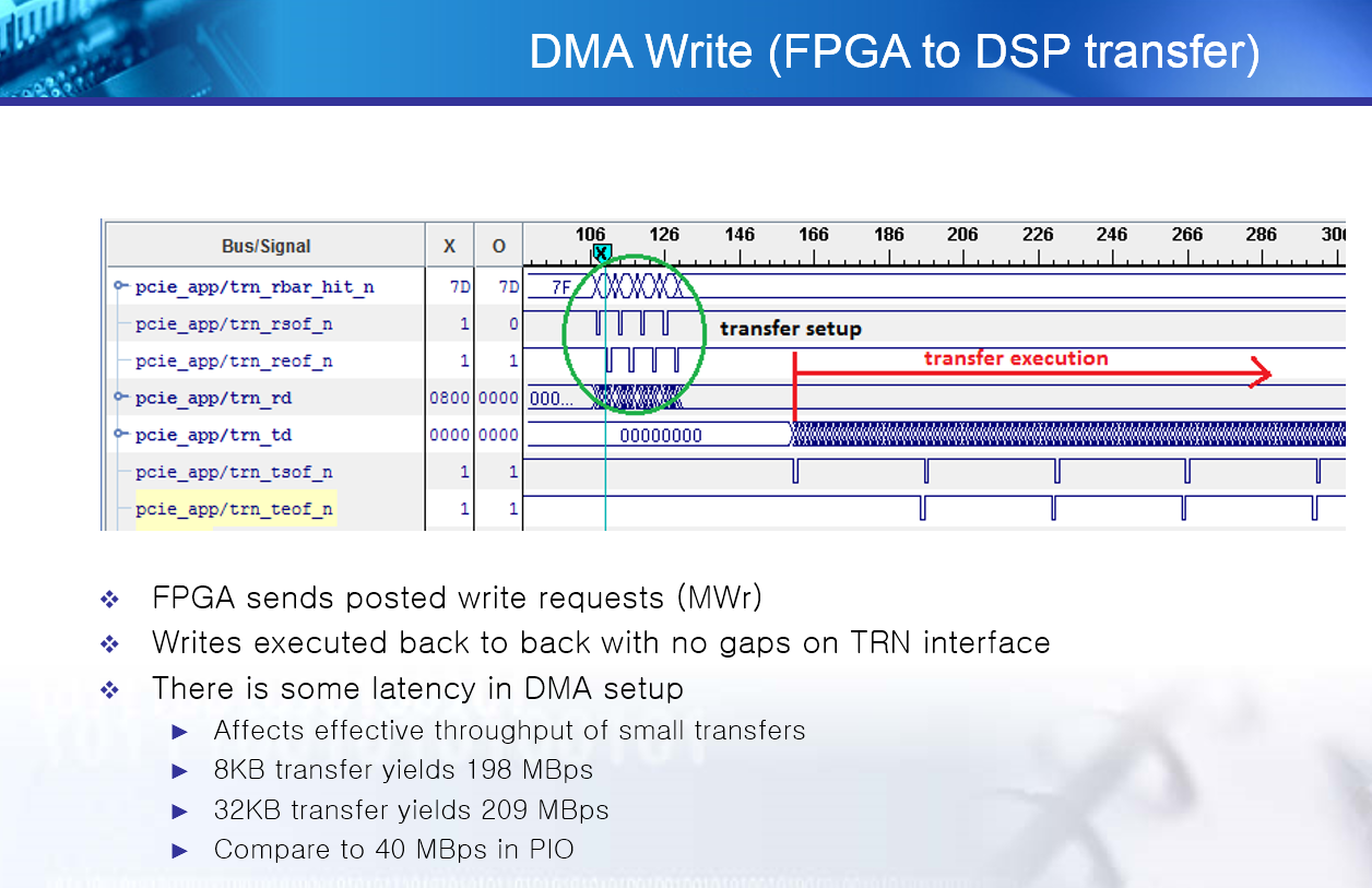

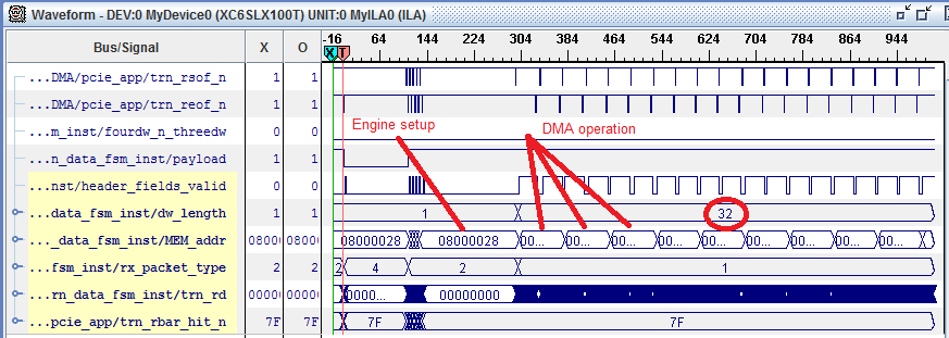

    Just to make sure, I have triggered DSP-to-FPGA transfer using DMA engine in FPGA:
    Note, that after transfer setup, data coming in packets with 32DW=128B payload. Packet type is different, because FPGA was requesting reads, and DSP responds with Completer TLPs. Important conclusion from this experiment is that PCIe subsystem is capable to form and transfer 128B payload. However, that does not happen, when PCIe transfer was requested by EDMA.
    As to transfer speed, I made rough experiment and saw transfer rate of about 180MBps comparing to 200+MBps with FPGA's engine.
    We may estimate link utilization ratio as (64B payload) / (64B payload + 12B header) = 84% versus (128B payload) / (128B payload + 12B header) = 91%. Not critical, but visible.

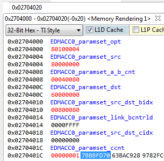

    I see the handle to paramset in my case is 0x02704600. At that address I see reasonable parameters landed. Perhaps, that needs more attention, but in any case, the true issue is payload size in EDMA initiated transfers.
    Please assist debugging that.
    Thanks in advance.
    Victor
  • Hi again,
    When selecting PaRAM entry, I place
    CSL_edma3MapDMAChannelToParamBlock( hModule, FPGA_EDMA_TX1_R, 8 * FPGA_EDMA_TX1_R );
    That is entry #48, thus 48*0x20=0x600, and handle I've got 0x02704600 is correct. I made sure all configuration values from my config structure land to PaRAM location exactly the same. I am afraid, I am missing something important, that A-sync transfers don't work as I expect, but at least AB-sync transfers run well, and with them I definitely see TLP payload of 64B, which is less than expected DBS fragmentation. Let us concentrate on this issue.

    Nevertheless, I have tried with channel #0, PaRAM set #0. Parameter landed to memory were:
    In my code I had:
    dma->rght.prm.cfg.option = CSL_EDMA3_OPT_MAKE
                CSL_EDMA3_ITCCH_DIS,        // itcchEn,
                CSL_EDMA3_TCCH_DIS,         // tcchEn,
                CSL_EDMA3_ITCINT_DIS,       // itcintEn,
                CSL_EDMA3_TCINT_EN,         // tcintEn,
                FPGA_EDMA_TX1_R,            // tcc,
                CSL_EDMA3_TCC_NORMAL,       // tccMode,
                CSL_EDMA3_FIFOWIDTH_NONE,   // fwid,
                CSL_EDMA3_STATIC_DIS,       // stat,
                CSL_EDMA3_SYNC_AB,           // syncDim,
                CSL_EDMA3_ADDRMODE_INCR,    // dam,
                CSL_EDMA3_ADDRMODE_INCR     // sam
            dma->rght.prm.cfg.srcAddr     = (Uint32) src;//pcie_buf;
            dma->rght.prm.cfg.aCntbCnt    = CSL_EDMA3_CNT_MAKE( 128, 4 );
            dma->rght.prm.cfg.dstAddr     = (Uint32) dst;
            dma->rght.prm.cfg.srcDstBidx  = CSL_EDMA3_BIDX_MAKE( 128, 128 );
            dma->rght.prm.cfg.linkBcntrld = CSL_EDMA3_LINKBCNTRLD_MAKE( CSL_EDMA3_LINK_DEFAULT, 0 );
            dma->rght.prm.cfg.srcDstCidx  = CSL_EDMA3_CIDX_MAKE( 0, 0 );
            dma->rght.prm.cfg.cCnt        = 1;
    For OPT field we see
    • PRIV=1 - have no idea;
    • TCINTEN=1 - just right;
    • SYNCDIM=1 - matches CSL_EDMA3_SYNC_AB.
    Src, Dst addresses as well as counts seems right too. However, even in this case still I see 64B payload size. This behaviour is observed as for AB-sync transfers, so for A-sync transfers. I have tried blocks as large as 128*1024.

    PRIV = 1 is Supervisor level privilege, this is expected. I didn't see anything wrong in the code, I don't have scope setup to capture PCIE TLP to determine the payload size. So we normally run the PCIE throughput test with different CC/TC combination, to show the DBS in the TC as expected by seeing the difference in throughput.

    • read performance was better because PCIeSS responds with 128B TLPs on read requests.
    • write performance was worse because EDMA3 initiated transfers result in 64B TLPs.

  • Hi Eric,
    I talked to my lab people, we have only 1GHz scope there, so I could not quickly prove my findings with scope either.
    However, I found another confirmation to my guess. Although responder part is not ready in my FPGA firmware, still I can monitor incoming request. Thus, in EDMA config I have swapped source and destination, which makes the transfer effectively read request, transfer from FPGA to DSP. And guess what? Bingo! When EDMA3 initiates read transfer, that is transmits read request and waits for completer, in such a case amount of data requested is 0x20=32DWORDS! In subsequent request address also jumps by 0x80.
    That's what I guessed: EDMA makes 64B writes, but 128B reads. That explains performance numbers in SPRABK8 PCIe Use Cases report.
    To make sure I tried to issue read request through EDMACC1, and amount of data requested had reduced to 16DW=64B.
    Thus my observation is that at least in my setup, x1 Gen.1 EDMACC0 can make DBS=128B large reads, but only 64B writes. Sure, there might be some minor omission, mistake or so, but it looks pretty much as implementation feature was not properly documented.
    I am taking this issue very seriously. Throughput is minor concern, as under 10% degradation should be well covered by design margin. However, under impression that one may get better performance on EDMA3CC0 user might be oversubscribing that controller, which is also item of choice for memory transfers, TCP and FFTC service, while other EDMA instances have more channels and PaRAM entries.
    Although my colleague proposed to borrow higher bandwidth scope and test physical wire, I wish TI review this issue in their lab to have their own view. Nevertheless, I am willing to make every possible test on my side should it be required.
    Thanks.
