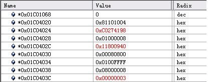

I use c6747. When I use edma, I meet a very strange problem. I want to move four columns. When the program runs, I find the first, second and third columns are moved successfully. But the fourth column isn't moved. To find the reason, I put a breakpoint on the enable transport function, and then I find all of the four columns can be moved. If I add a function of printf after the enable transport function, the four columns also can be moved without a breakpoint. I don't know why and how to reslove this problem. Can somebody help me?

  • 1. I use EDMA3 LLD to program.
    2. using DMA.
    3. I use one PARAM set.
    4. The PARAM register set as follows:
    opt:0x00101004              srcAddr:0xC0274190                    acnt:0x008                     bcnt:0x0100                   destAddr:0x11800140                  srcBidx:0x800             destBidx:0x0008
    linkAddr:0xFFFF             bcntReload:0x0100                        srcCidx:0x0008            destCidx:0x0800           ccnt:0x0004
    5. After the failure occurs the values are the same as settings.
    6. After operation is successful, the values chang to zero except for linkAddr.
    7. No.
    8. I see both the data and the IPR bit.
    When I enable ITCINTEN and TCINTEN bit in OPT, the operation is successful. But I don't want to enable ITCINTEN bit for some reasons. I watch the SASRCBREF and DFDSTBREF values of EDMATC0 in register window, find some differences between failure and success as follows:

  • My english is not very good, so sometimes I can't express myself exactly.
    a.  I use CPU(through ESR) to generate the four events.
    b. when it's success, the values in the EDMA3CC are: EMR=0x00,ER=0x00,CER=0x00,SER=0x00,IPR=0x02.
    when it's failure, the values in the EDMA3CC are:EMR=0x02,ER=0x00,CER=0x00,SER=0x00,IPR=0x00.
    c. I use channel 1 and paRAM 1.   The  address of paRAM 1 starts from 0x01C04020.

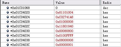

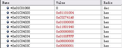

    d. When the failure occurs, I see neither the IPR bit nor the data(the fourth column) has moved.

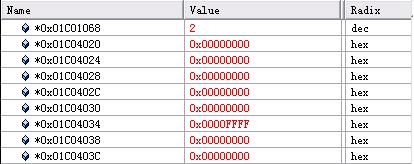

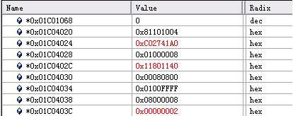

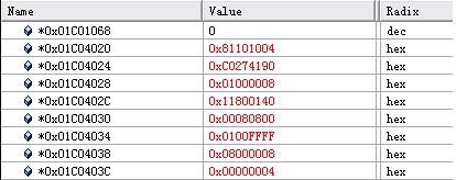

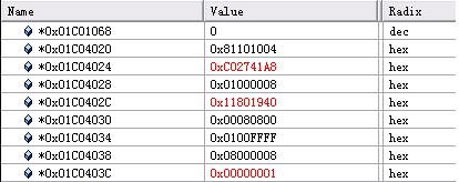

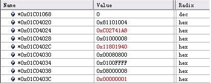

    e. There are 5 pictures about successful operation:
                                     tranfer the first column
                                   transfer the second column
                                   transfer the third column
                                    transfer the fourth column
     After enabling  the channel four times, the PC point jumps from the function, and the values of IPR and paRAM change as follows:
                            after transfering all of the data
    There are one picture about failed operation. It shows values of IPR and paRAM when PC point jumps from the function:
     From the picture about failed operation, data of the fourth column don't be moved. Why it happens?

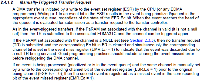

    Usually, SER is set also when EMR is set, so I am surprised that it is 0x00. But the fact the EMR = 0x02 confirms that an event was missed. This means that one of the CPU writes to ESR happened before the previous write to ESR had been serviced by the EDMA3CC Channel Controller.
    The way you have architected your transfer sequence, with CCNT=4, requires you to write to ESR 4 times. Because you do not have ITCINTEN set, there is no simple indication available to tell you when each transfer has completed. This requires you to wait an arbitrary amount of time between writes to ESR, and that amount of time is not enough.
    The simplest way to fix this is
    1. Set ITCCHEN=1 in the OPT register.
    2. Only write to ESR once, so keep the first time but remove the other 3 times that you write to ESR.
    If you want to understand how chaining works, the EDMA3 User's Guide has the details. In the Training section of TI.com, there is a training video set for the C6474. The EDMA3/QDMA/IDMA Module may help with the explanation of chaining. You can find the complete video set at http://focus.ti.com/docs/training/catalog/events/event.jhtml?sku=OLT110002 .

  • wu wu said:
    C6747 has 4 des entries,so I think it can accept 4 tranfer requests at one time. Do I misunderstand the meaning of 4 entries?
    What is the "des entry" you are talking about? In any case, yes, you misunderstand the meaning of 4 entries.
    wu wu said:
    Is ESR's value  invisible? Reading ESR after writing to it, I find its value doesn't change.
    No, ESR's value is not invisible, although it is rare to read a non-zero value there.
    Please show the exact program snippet that you use to write to ESR four times.
    It sounds like you are writing to ESR four times in a row without waiting to see if it is ready. If I am predicting the contents of your code snippet correctly, this is where your failure occurs.
    The recommended way to execute an ABC 3-dimensional transfer is to use chaining as I described above.
    The recommended way to use multiple ESR writes to step through an ABC 3-dimensional transfer is to poll IPR for completion of each transfer. Use Early Mode if you want to improve on the ESR write rate. An example would be to use the following pseudo code:

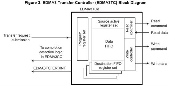

  • There are something about entries of destination FIFO register set in the c6747's datasheet:
    Based on above, I think I think it can accept 4 tranfer requests at one time. If I misunderstand this meaning, can you tell me how to understand above information?
    I now understand that you were using the term "des entries" to refer to the "Destination FIFO register sets". Thank you for the clarification.
    If you submit the TRs correctly, you can have 4 TRs "in-flight" meaning that 4 TRs can be active in the TC at one time. But the TC can only be reading data for one (1) TR at a time. The Destination FIFO register sets are for storing data to be written, not TRs to be executed; there is a difference. And the FIFOs are limited in size, which will limit the number of TR writes that can be buffered in the FIFOs.
    The problem here is that you are not submitting the TRs correctly. Please refer to the following section from the EDMA3 UG.
    In the second paragraph, it says "the TR is submitted to the associated EDMA3TC and the channel can be triggered again." This also means that the channel cannot be triggered again until the TR is submitted to the TC". In this case, you are triggering the channel too soon, before the TR has been submitted to the TC. This is not the recommended way to trigger the channel.
    The fourth paragraph explains the exact failure that occurs here. When you trigger a channel too soon, that is while it is still in the prioritization process or while it is still in the event queue (TR has not been submitted to TC), then the ESR.En bit may not be cleared before you write to it again. When you write to ESR.En again while ESR.En=1, the event is marked as being missed and this event will not result in another event being prioritized or enqueued. Since you have seen EMR.En=1, this is the indication that this has occurred.
    The recommended way to trigger the same channel multiple times is what I outlined in my previous post using pseudo code.
