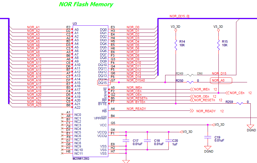

AM3352: GP EVM NOR flash
Part Number: AM3352
With regards to AM335x EVM NOR flash.
The EVM schematics shows that "DQ15" pin of NOR Flash is connected to
A0(NOR_A0) pin of GPMC. Could you please let us know what is the
reason that DQ15 is connected to A0. As per the TRM, A0 pin should not be
used with 16 bit NOR flash.
Best Regards
Kummi
    Note that the NOR is wired for 8-bit access (BYTEn pin tied to GND). On M29W128G DQ15 description is as follows: When the device operates in x16 bus mode, this pin behaves as data I/O, together with DQ[14:8]. When the device operates in x8 bus mode, this pin behaves as the least significant bit of the address.
