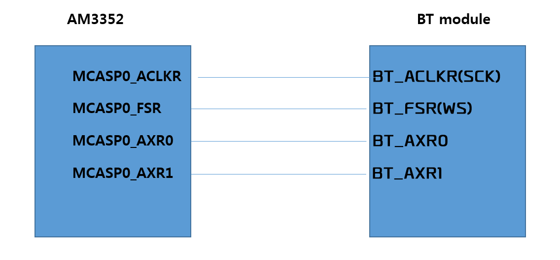

MCASP0 in AM3352 conntected BT module like below.

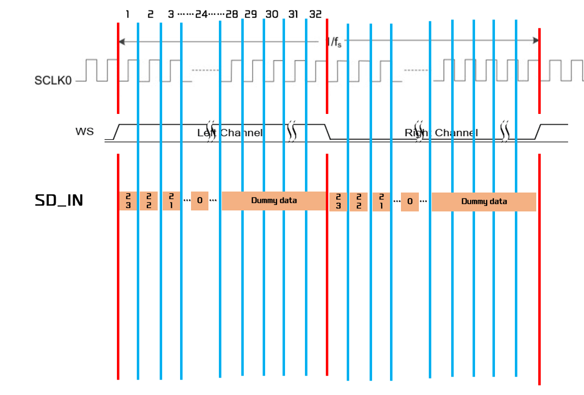

I set AM3352 Audio Slave , BT module Audio Master, then BT Module transer sclk, ws, data like below.
 I would like to know if the AM3352 can receive the above audio waveforms.
[ws = 44.1kHz, sclk = 2.82M(44.1k x 64), data is 24bit but sclk is 32sclk(last 8bit data is dummy)]
If the AM3352 can receive the above audio waveform,
, I wanna know HOW to  AM3352 Resister and I want to check HW design information.
