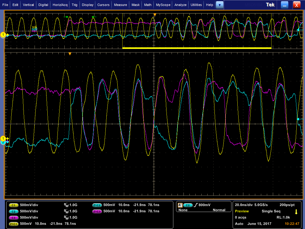

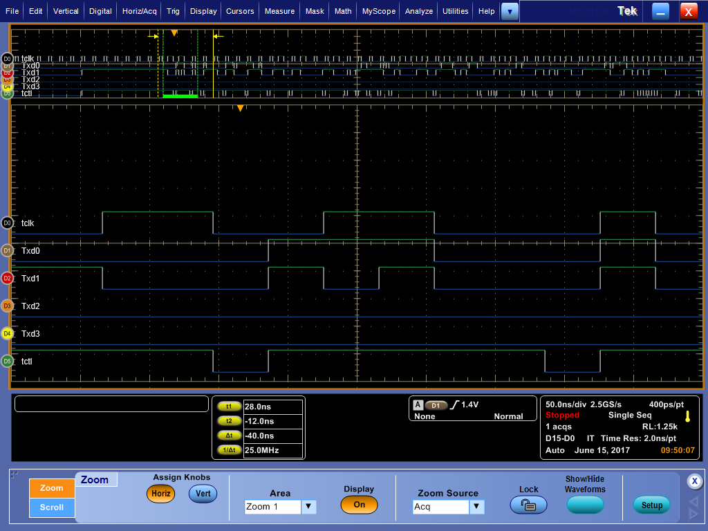

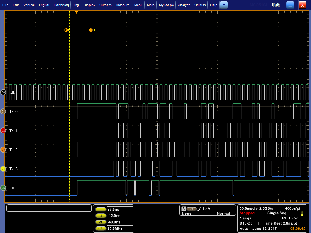

  • DK,
    Thank you for the response.  I went and checked the transmit signals with an MSO5104, both with the logic analyzer section (to capture CLK, TXD[3:0], and CTL) and the analog portion (just CLK, TXD[1:0], and CTL).  Surprisingly, when I had all analyzer leads connected, the board averaged almost 370 Mb/s.  I then started removing one lead at a time, and the speed got progressively worse.
    With the analog channels, I didn't see anything very ugly on the data lines.  There's some overshoot, but nothing I see to cause issues.  I suspect that the ~4 pF of capacitance that's added each time I add a scope probe is rounding off edges enough to improve the speed.  I don't think this is related to the AM3358 anymore.
    CH1 = TCLK, CH2 = TXD0, CH3 = TXD1
    All probe leads attached

    Removed logic analyzer lead from TXD0

    Logic analyzer leads removed from TXD0, TXD1, TXD2, TXD3

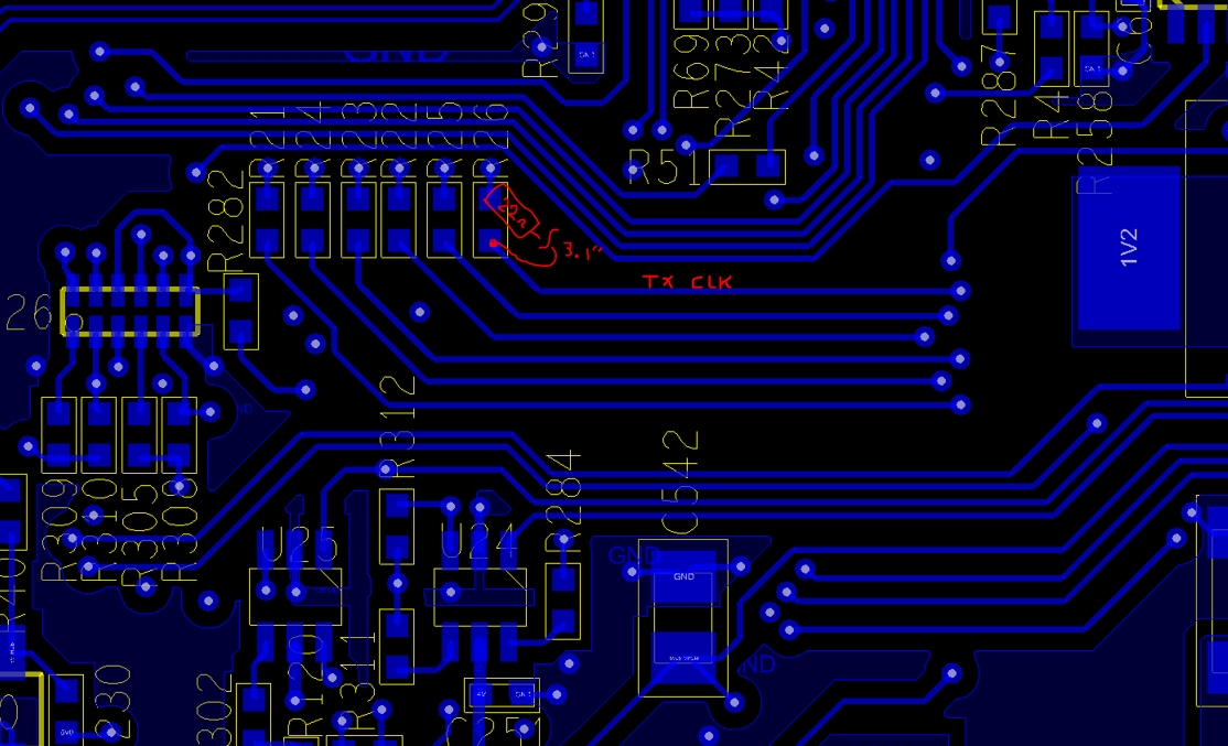

  • Interesting.
    What values are you using for your RGMII series resistors?
