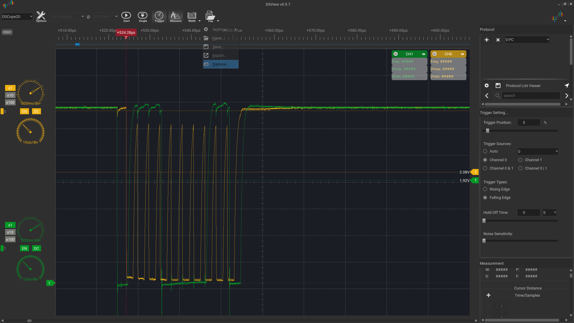

    I'm posting some traces.
    TITLE: SCL, 100Khz scope 1x, of i2c2. no external pull-up just internal.
    TITLE: sda/scl 400Khz no external pull-up
    Comments: In this condition the kernel is very sensible to what happens in the bus. If it stretch too much because of the rise time or placing a capacitor of 60pF in the bus,  cause immediate freeze if the i2c bus is polled.

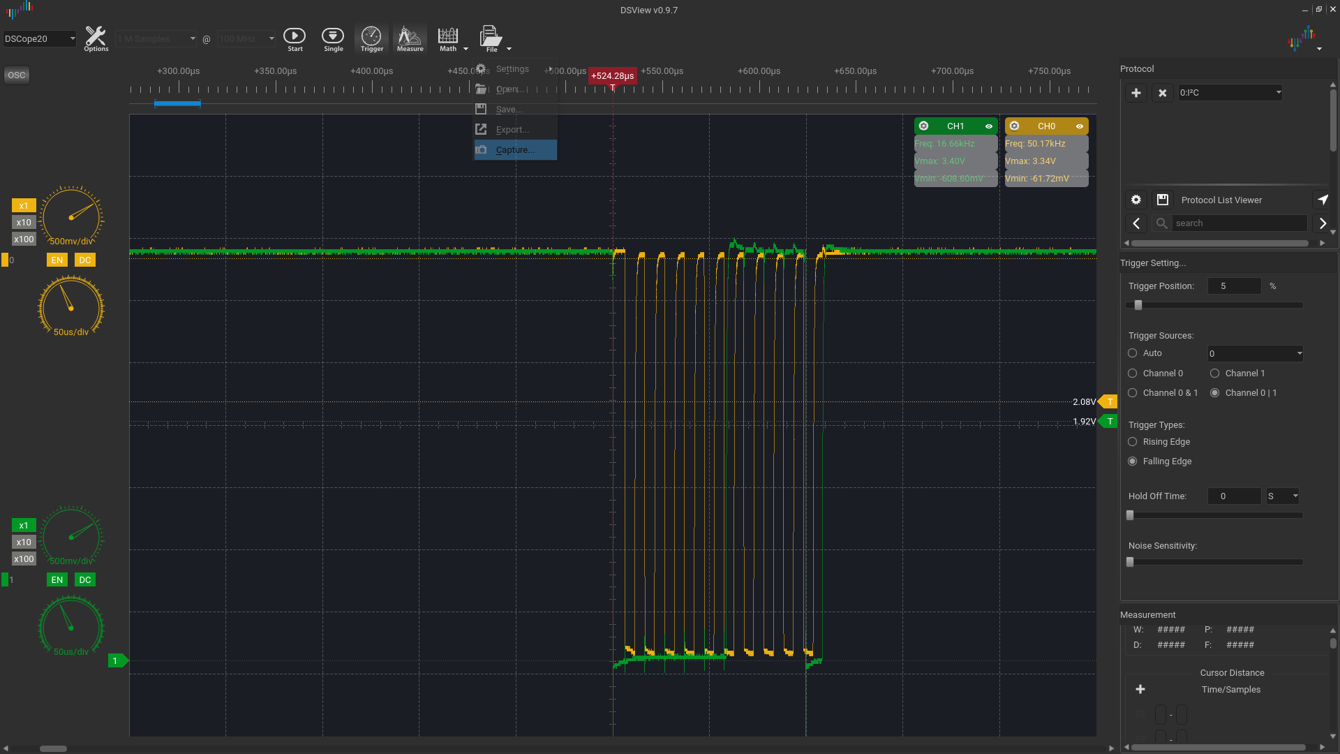

    TITLE: sda(green)/scl(yellow), 4K Ohm external pull-up, 100Khz
    Comments: The rise time is now "fixed" even placing a capacitor to torture the i2c makes the waveform stable. No deadlocks when polling.
    Conclusion:
    It seems that there was indeed a communication issue. Said that, I still don't know if it's an expected behavior for the kernel to completely freeze for a "bad communication".
    What do you think?

  • Hi Leonardo,
    Strong external pull ups are required on I2C lines per the spec (http://www.nxp.com/documents/user_manual/UM10204.pdf).   On our EVMs, we typically have values of 2.2K ohm.  It is possible the kernel driver is making some assumptions based on proper bus behavior, but it sounds like your issue is resolved now.
    TI has an app note that will help you calculate values for your system:
    The Linux kernel driver was likely written with the assumption these resistors are in place, otherwise, I
