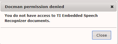

    I want to creat a new _fil "phone model" for Chinnese and i do not know how to do this.Following your suggestion,i went to https://gforge.ti.com/gf/project/tiesr  for help.But after creating an account i still did not have access to TI Embedded Speech Recognizer documents.
    How can i get the documents and examples?Must i join the project?
    Also i submitted an application to join the project,but did not get a response.What should i do to get the documents and examples?

  • Hi Eric,
    Even I tried the same. Even I dont have access to those files. I think the documents you're looking for are in this link:
    www.ti.com/.../TIDEP0066
    Download TIDEP0066 Software ZIP package at the end of the page. It contains various documentation. Hope this is what you're looking for.

  • Hi Eric,
    As for the documentation for _fil model creation, there is none. You just need to follow the tips and leads given by Lorin in this post thread.
