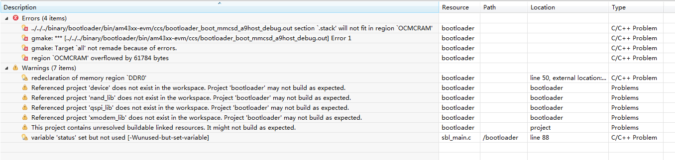

Hi :
I try to compile bootloader project in starterware for am4378.
My ccs version is 6.1.2, compiler is GNU v4.9.3.
At first, I import the bootloader project. Then import the necessary dependent project and config them as below.
At last, I compile the bootloader ,but there are several errors and warnings as show below.
**** Build of configuration am43xx_boot_mmcsd_debug for project bootloader ****
"D:\\ti\\ccsv6\\utils\\bin\\gmake" -j 4 -s -k all
'Building file: D:/ti/starterware/examples/mmcsd/hsmmcsd_app_pol.c'
'Building file: D:/ti/starterware/examples/gpio/gpio_app.c'
'Building file: D:/ti/starterware/bootloader/src/am43xx/sbl_am43xx_platform.c'
'Building file: D:/ti/starterware/bootloader/src/am43xx/sbl_am43xx_platform_ddr.c'
'Invoking: GNU Compiler'
'Finished building: D:/ti/starterware/examples/gpio/gpio_app.c'
'Finished building: D:/ti/starterware/examples/mmcsd/hsmmcsd_app_pol.c'
'Finished building: D:/ti/starterware/bootloader/src/am43xx/sbl_am43xx_platform.c'
'Finished building: D:/ti/starterware/bootloader/src/am43xx/sbl_am43xx_platform_ddr.c'
'Building file: D:/ti/starterware/bootloader/src/sbl_copy.c'
'Building file: D:/ti/starterware/bootloader/src/am43xx/sbl_am43xx_platform_pll.c'
'Building file: D:/ti/starterware/bootloader/src/sbl_main.c'
'Building file: D:/ti/starterware/bootloader/src/sbl_mmcsd.c'
D:/ti/starterware/bootloader/src/sbl_main.c: In function 'main':
D:/ti/starterware/bootloader/src/sbl_main.c:88:14: warning: variable 'status' set but not used [-Wunused-but-set-variable]
uint32_t status;
'Finished building: D:/ti/starterware/bootloader/src/sbl_copy.c'
'Finished building: D:/ti/starterware/bootloader/src/sbl_main.c'
'Finished building: D:/ti/starterware/bootloader/src/sbl_mmcsd.c'
'Finished building: D:/ti/starterware/bootloader/src/am43xx/sbl_am43xx_platform_pll.c'
'Building target: ../../../binary/bootloader/bin/am43xx-evm/ccs/bootloader_boot_mmcsd_a9host_debug.out'
'Invoking: GNU Linker'
d:/ti/ccsv6/tools/compiler/gcc-arm-none-eabi-4_9-2015q3/bin/../lib/gcc/arm-none-eabi/4.9.3/../../../../arm-none-eabi/bin/ld.exe:../../../examples/gcc/am43xx_boot_ccs.lds:50: warning: redeclaration of memory region `DDR0'
d:/ti/ccsv6/tools/compiler/gcc-arm-none-eabi-4_9-2015q3/bin/../lib/gcc/arm-none-eabi/4.9.3/../../../../arm-none-eabi/bin/ld.exe: ../../../binary/bootloader/bin/am43xx-evm/ccs/bootloader_boot_mmcsd_a9host_debug.out section `.stack' will not fit in region `OCMCRAM'
d:/ti/ccsv6/tools/compiler/gcc-arm-none-eabi-4_9-2015q3/bin/../lib/gcc/arm-none-eabi/4.9.3/../../../../arm-none-eabi/bin/ld.exe: region `OCMCRAM' overflowed by 61784 bytes
collect2.exe: error: ld returned 1 exit status
gmake: *** [../../../binary/bootloader/bin/am43xx-evm/ccs/bootloader_boot_mmcsd_a9host_debug.out] Error 1
gmake: Target `all' not remade because of errors.
**** Build Finished ****
Is there anyone who have come across this problem that can give a hand?

  • Hi Lali:
    There are two link cmd file:
    1.am4378.lds
    MEMORY
    DDR0 : o = 0x80000000, l = 0x10000000 /* 256MB external DDR Bank 0 */
    OCMCRAM : o = 0x40300000, l = 0x40000 /* 256KB of internal RAM */
    OUTPUT_FORMAT("elf32-littlearm", "elf32-littlearm", "elf32-littlearm")
    OUTPUT_ARCH(arm)
    SECTIONS
    .startcode :
    . = ALIGN(4);
    *init.o (.text)
    } >OCMCRAM
    .text :
    . = ALIGN(4);
    *(.text*)
    *(.rodata*)
    } >OCMCRAM
    .data :
    . = ALIGN(4);
    *(.data*)
    } >OCMCRAM
    .bss :
    . = ALIGN(4);
    _bss_start = .;
    *(.bss*)
    *(COMMON)
    _bss_end = .;
    } >OCMCRAM
    .heap :
    . = ALIGN(4);
    __end__ = .;
    end = __end__;
    __HeapBase = __end__;
    *(.heap*)
    . = . + 0x800;
    __HeapLimit = .;
    } >OCMCRAM
    .stack :
    . = ALIGN(4);
    __StackLimit = . ;
    *(.stack*)
    . = . + 0x10000;
    __StackTop = .;
    } >OCMCRAM
    _stack = __StackTop;
    2.am43xx_boot_ccs.lds
    MEMORY
    OCMCRAM : o = 0x402F4000, l = 0x2FC00 /* 256KB of internal RAM */
    OUTPUT_ARCH(arm)
    SECTIONS
    .startcode :
    . = ALIGN(4);
    *sbl_init.o (.text)
    } >OCMCRAM
    .text :
    . = ALIGN(4);
    *(.text*)
    *(.rodata*)
    } >OCMCRAM
    .data :
    . = ALIGN(4);
    *(.data*)
    } >OCMCRAM
    .bss :
    . = ALIGN(4);
    _bss_start = .;
    *(.bss*)
    *(COMMON)
    _bss_end = .;
    } >OCMCRAM
    .heap :
    . = ALIGN(4);
    __end__ = .;
    end = __end__;
    *(.heap*)
    . = . + 0x800;
    __HeapLimit = .;
    } >OCMCRAM
    .stack :
    . = ALIGN(4);
    __StackLimit = . ;
    *(.stack*)
    . = . + 0x10000;
    __StackTop = .;
    } >OCMCRAM
