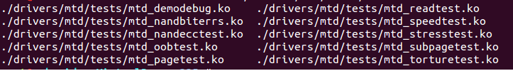

After NAND parameter porting, the mtd test embed in Linux has been used for testing.
However there are some errors after test.
Here it's the test result of MTD test code.
  mtd_nandbiterrs.ko  mtd_oobtest.ko  others
MT29F4G08ABAEAWP OK OK OK
TC58NVG2S0HTA00 NG, the 1st OOB data has been corrupted during write data area only. NG,
1 bitflip exist more than 10 units data
OK

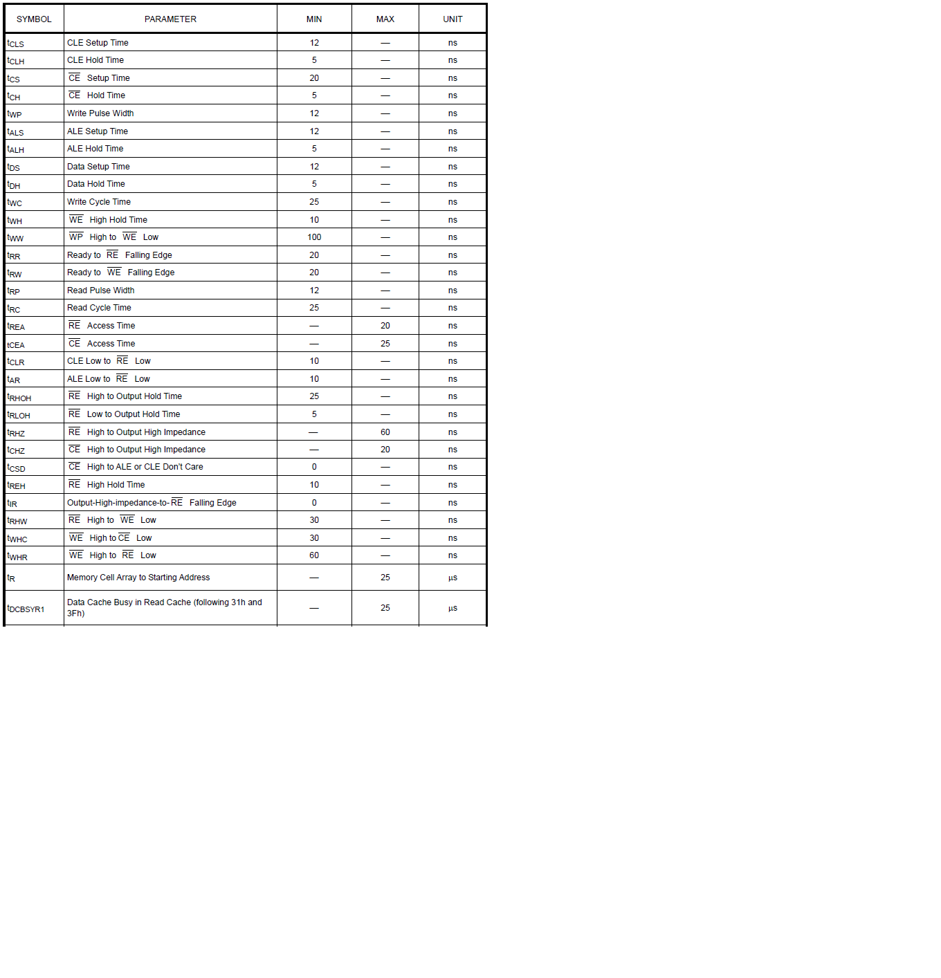

From the test result, I don't know what's the actual reason. therefore I  doubt that weather the GPMC timing is reasonable. But I do not find the details for how to configure the nand timing in the specification.
Can you help to check the timing parameters for TC58NVG2S0HTA00?
Thank you in advanced.
1) MPU Setting Timing
2) Toshiba TC58 Timing
